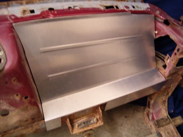

Im going to make my own fender liners and this it what im going for. i have a 302 with the On 3 turbo kit, will the turbo or anything interfere with the panel seeing that it takes up some room that the stock liners had. if i had the motor in i would be able to look for myself but the front half of the car is apart.

The drivers side has plenty of room....Its the passenger side thats tight....

thats good to know. i ended up making my own as well and look just like yours. insted of a stright shot to the frame rail i but another bend in it about 4 inches down from the top.
