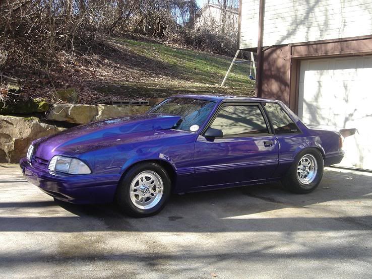

Car Now (Pictures look 100x better than actual paint. Paint clear is almost all flaked, lots of misc dings/scratches/flaws.)
