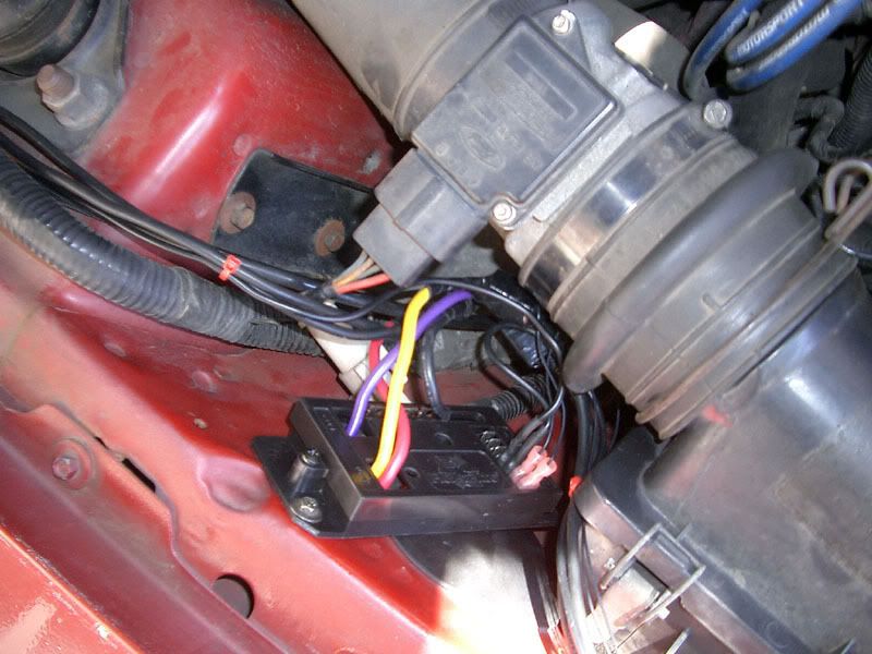

Flexalite 33054 VSC:
Mount near stock airbox on passenger side of engine bay. Uses one sheet metal screw in pre-existing hole.
You should buy this unit (about $95 at Summit) because the cheaper ones can't handle the amps of the Taurus fan, and will fail (from post
on another thread by a disappointed user)!

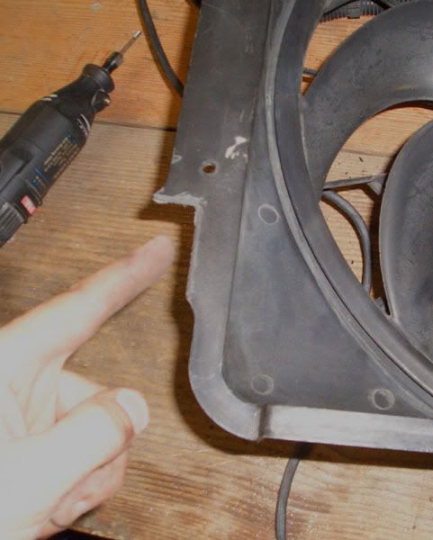

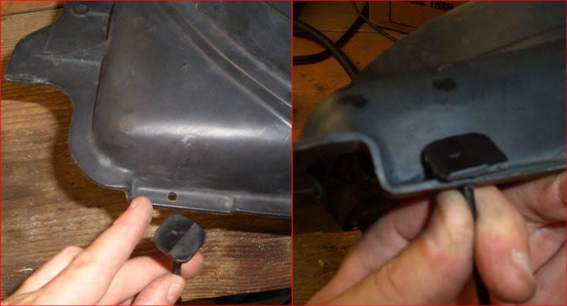

Remove the protrusion on the shroud that would prevent the shroud from sitting flush on the radiator. Cut shroud with hacksaw, grind sharp
edges off with dremel (or coarse sand paper).

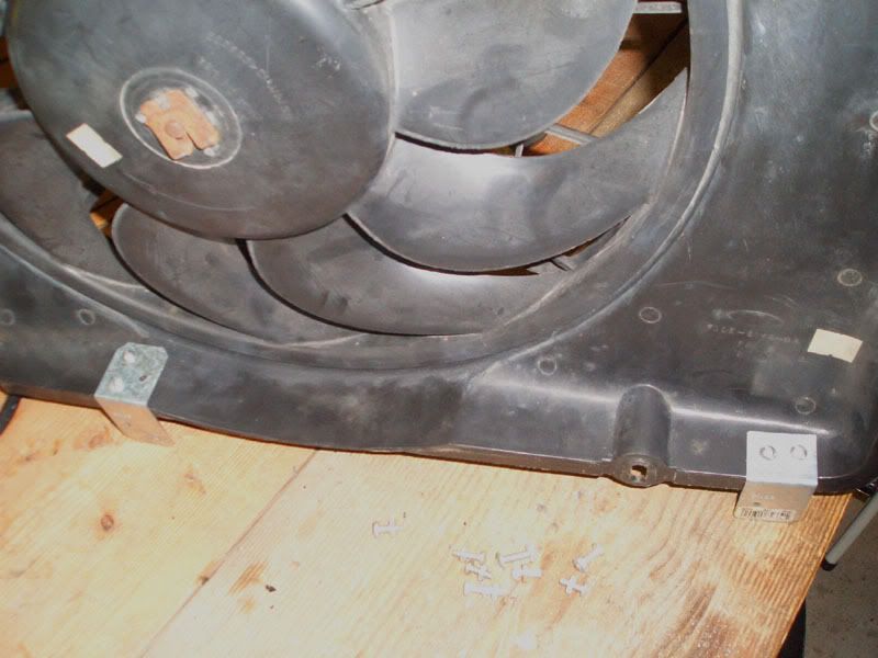

The lip around the shroud doesn't leave a lot of room for the radiator zip fasteners. I used 3 across the top to secure the
shroud/fan/overflow bottle to the radiator. Here is a photo of the passenger side upper corner, with the hole I drilled and the trimmed
zip fastener. Bend the stem of the fastener to allow the head to fit the contour of the shroud.
Use 2 L-brackets in the locations shown so they fit into the stock clips in the lower frame (that the stock shroud used). Bend them a
little bit towards the back of the car so the shroud is pressed up against the radiator. The driver's side L had to be trimmed a little
since the shroud was shallower there.

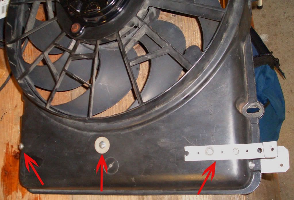

Drill 2 holes in the shroud to be used with the stock holes of the overflow bottle. The center hole of the bottle uses a washer. I made a
mounting bracket out of galvanized band iron. One of the overflow bottle's lower tabs fits into it (much like the L-brackets do on with
the frame clips). You could put a screw through the band iron once the bottle is in there, but I didn't bother. It was secure enough just
sitting in it. The photo shows the location of the bolts that would fasten the bottle to the shroud, and the bandiron mounting bracket
(see arrows):

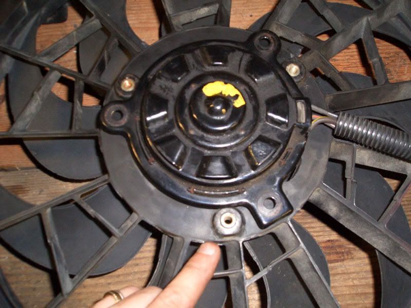

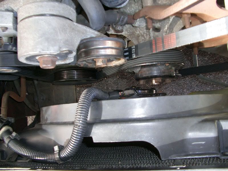

OPTIONAL: I wanted the fan's stock wiring to come up the top. To do this I had to "clock" it by removing the screws and rotating the
plate 1 hole counterclockwise. This required grinding the one square tab so the round mount could fit on it correctly. The photo shows
the screws removed, the square tab next to its former mount, and the mount ground (with dremel) so that it was rounded off. NOTE: I found
the wire loom is kind of in the way when you have to change the serpentine belt (using a 1/2" ratchet to move the tensioner). You may not
want to bother with this. I did it and took pics though, so I'm including it here:

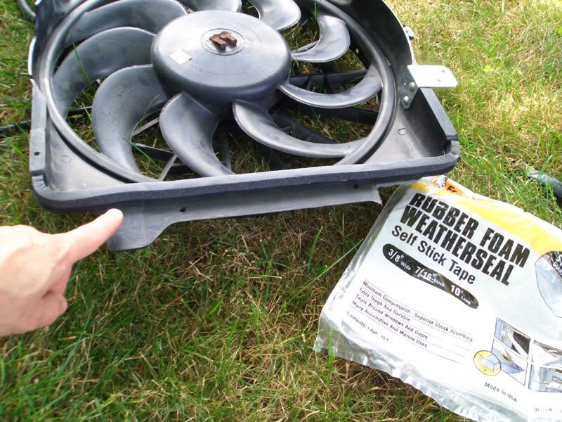

Lastly, the passenger side of the shroud needs to be sealed with rubber weather stripping. I used Frost King 3/8"x7/16".
Install the fan/shroud/bottle as previously mentioned: the L-brackets fit into the stock frame clips, then use 3 thru-radiator zips across
the top to hold the whole thing snug against the radiator. My shroud doesn't move at all and is tight up against the radiator. This pic
shows the clearance with the crank pulley and the stock wiring loom run up the top. You can just see the second zip fastener at the edge
of the picture in the lower right. The third is in an obvious location by the overflow bottle (not shown).
Flex-a-lite VSC
I removed the airbox so you could see better in the pics.

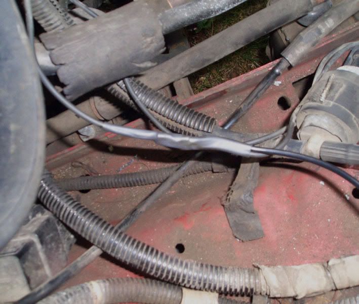

Key-on Hot:
The first thing I did was figure out where to get the Key-on-hot from. Thanks to Joel5.0 for this info from another thread. I
spliced into the hot feed to the Canister Purge Solenoid, which is keyed of course. This insulation was hard to strip off - it is bonded
to the wire. I carefully used a razor knife to remove the insulation without damaging the copper wire. You could just use a tap here, but
I wanted the splice to be housed safely in the wire loom, and a tap would not fit. The pics show the Solenoid with the cut wire; my crimp;
the crimp shrinkwrapped; then the taped up loom. The 14ga wire I used is run up from below the stock airbox to the VSC and attaches to VSC
pin #9. The photos are good examples of how I did my connections:

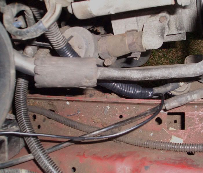

Fan power, Pos + Neg:
With the fan mounted, I drilled 2 holes in the shroud for the stock wire loom clips (which you can also see in a previous pic). I got my
fan with the loom connector intact, so I kept it and spliced into the connector wires (not the fan wires themselves). Use only the
high-speed feed wire and seal off the low speed wire. Use 10ga wire for both Pos and Neg, and rout the wires above the airbox (which I
did) or below it, to the VSC. Positive fan power goes to VSC Yellow wire; Negative goes to VSC Purple. The pic shows the 10ga wires
shrinkwrapped, and the low speed wire sealed off with shrinkwrap that I squeezed together while it was hot so it bonded to itself.

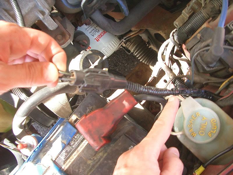

Battery main supply and negative:
These wires feed the power to the system. Use 10ga wire. Battery hot connects to the VSC Red wire, and the battery negative to the VSC
Black wire. Rout them around the back of the engine compartment to the battery/fuse link area on the driver's side. I used ring terminals
and connected them like this: the hot wire gets bolted to the hot of the starter relay (which is fed directly by the battery hot. The
negative gets screwed down with one of the body grounds that is connected directly to the battery negative wire. The pic shows me pointing
to both - pinky neg, index hot.

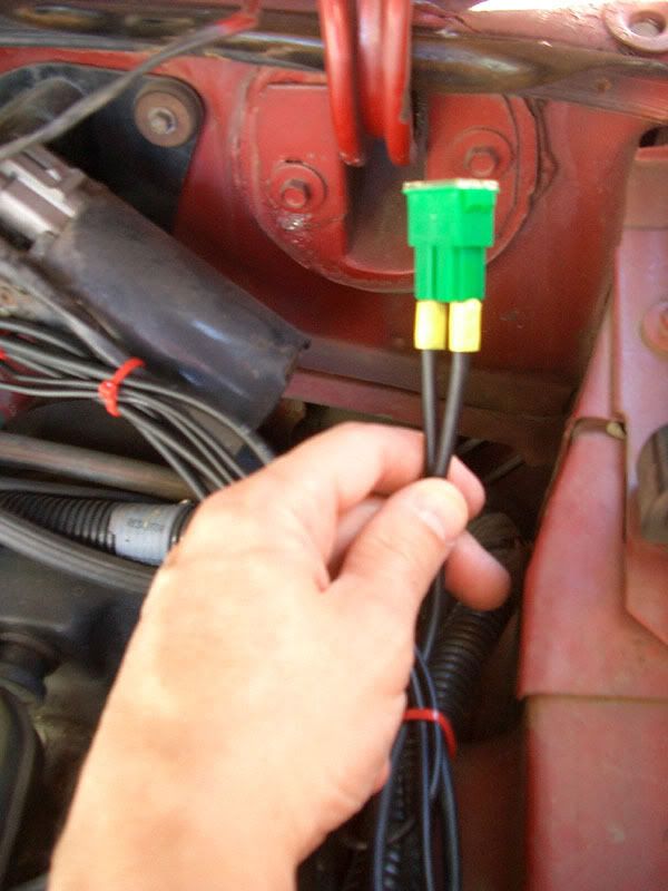

40A fuse:
The hot wire gets a 40A inline fuse. The one I used allowed male spade connectors to be inserted into it (see pic). I put this to the
back of the strut tower, away from the hood hinge.

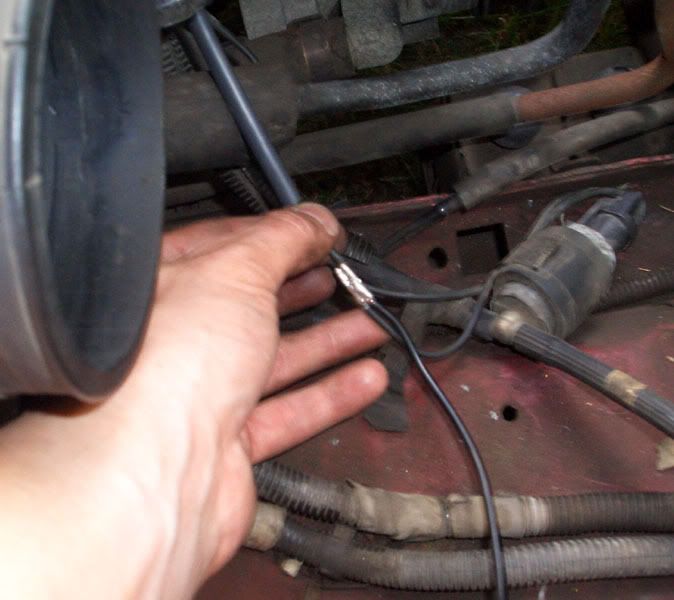

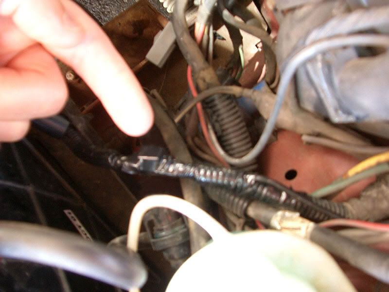

AC power on feed:
Lastly, I tapped into the AC Hot feed using 14ga wire, routed around the back of the engine compartment with the battery hot/neg. It
connects to VSC terminal #8. This allows the VSC to turn the fan on at 60% when the AC is turned on even if the engine is cold. I tapped
into the wire feeding the Black/Yellow AC wire. The first pic shows the tap taped up within the loom (I will probably replace this with a
splice to better fit into the loom, as I did with the key-on hot). The second shows it with the Black/Yellow wire it shares the signal
with.

The VSC mounts using one screw in a pre-existing hole behing the MAF. I trimmed its corner just a touch. The wiring doesn't look neat,
again, because I left it open for you to see. I'll be "looming it up" soon.

You could use either a fusible link or a breaker - a link
takes a tad longer to blow so it wouldn't blow on the
hi amp draw on startup. A breaker is resettable so
you wouldn't need to worry about having spare fuses.
315 Posts
Just to be 110% sure....the black wire with the yellow stripe is the one that will kick on the fan when the AC is turned on?
1,096 Posts
I think mine is black with green stripe.
2,107 Posts
While the Taurus fan has worked fine on my moderately warmed up 351, I have later found that the FAL actually will run a Lincoln Mark VIII fan just fine, in spite of the fact that FAL says it won't. (maybe so they can sell their own fans?)
I've got an earlier Mark VIII on my 5.9 SUV with the larger of the 2 FAL controllers and it works great.
And the Mark VIII fan draws actually hardly more amps but pulls quite a bit more air because of the improved blade design, and of course is larger so covers more of the radiator.
If you need some amp or size specs on a Mk8 fan, let me know.
