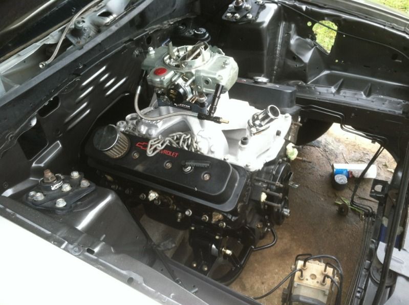

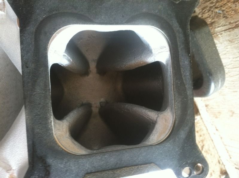

well some of you know that i blew my 4.6 up.... ( i knew it was gonna happen but just not this soon) never been a fan of ford motors..this was the first ford ive ever owned.. i built a 350 vortec for my truck last year to tow my mustang around...once i blew the car up i sold the truck minus the motor (has 6k miles on it) im going to be building a dart block 427 for next season but figured id use the motor to get me by and work out all the bugs for when i put my race motor in next year...
350 small block chevy
keith black pistons 10:1
906 vortec heads
234/244 510lift cam
heavy duty valve springs and retainers good for .550 lift
new lifters

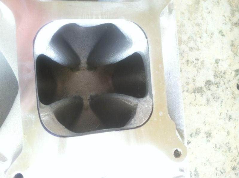

ported single plane high rise intake manifold
demon 650 carb
nitrous express plate kit (100-150 shot)
factory

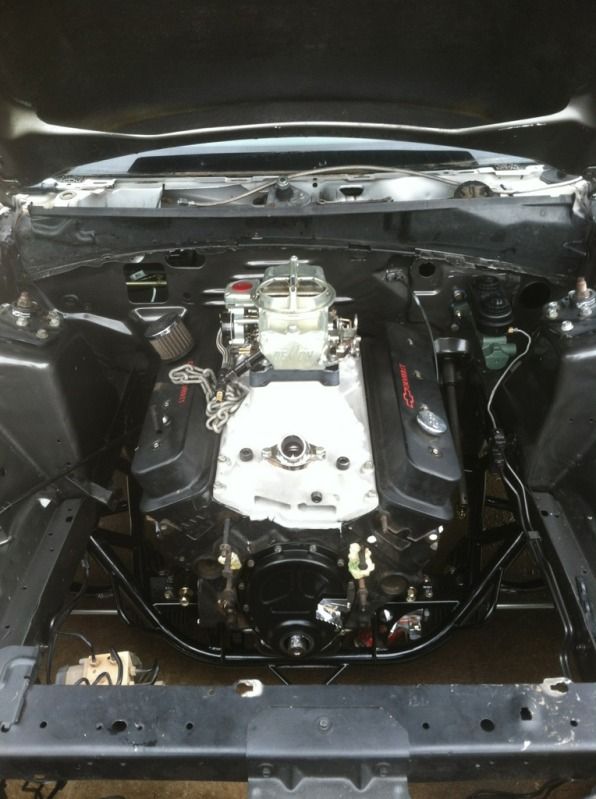

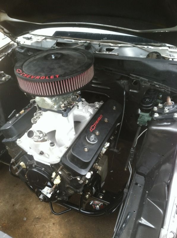

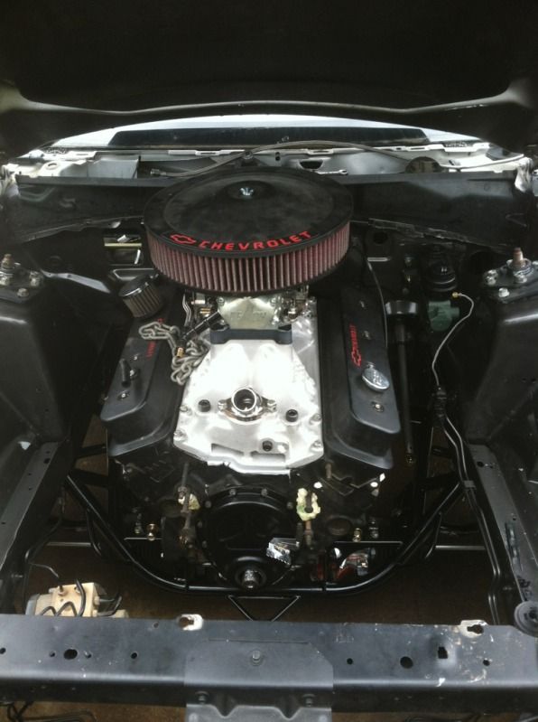

cleaned up

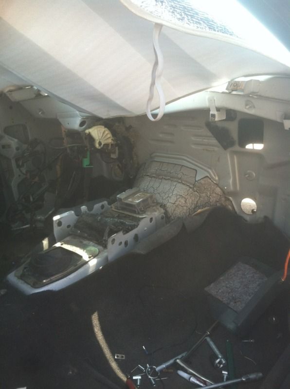

primed ready to be painted tomorrow..
bay has been sprayed metallic charcoal
pics arent that good but it looks good in person...
i added a piece of angle iron on the top over the fuel out lets to make it solid all the way across.. but anyways..cell is mounted
k member with tow hook and 2 tie down straps
