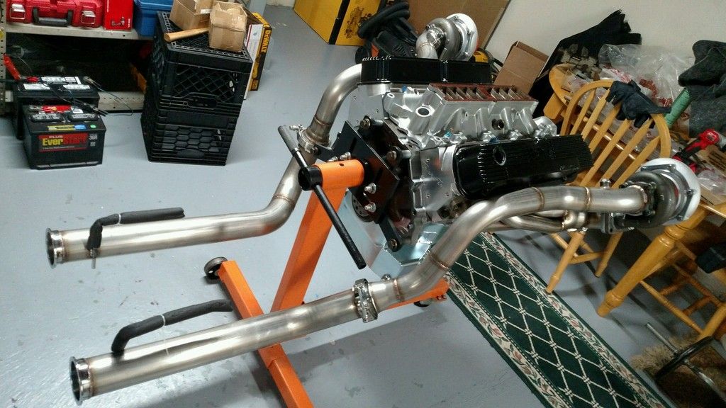

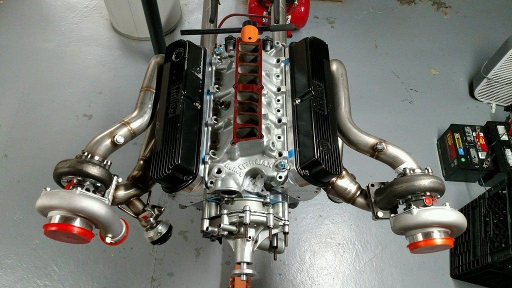

Everything fits real good. It will be easy to finish the exhaust. I'll use the tail pipes for a stock look.
The Turbos are in a good spot, so I think I can fab up some Rod End type supports with some round tubing. One on top and one on the bottom somewhere to triangulate them to the motor and relieve the weight on the Headers. Still need to do that!

Yes, It's CX. They have a new Single kit out with Dual Gates that looks cool. That would be way easier to work out. I might have done that if it was out at the time I bought, but the cool factor of TT's is hard to beat. Plus, I the car is intended for Street, so 2 smaller Turbos will get up on the Boost faster then 1 big hog.
One thing to mention is the Oil Drainback parts included are too narrow. I eBay'ed some larger -10 parts without to much trouble or extra expense. I'm working out the details now before I get the motor in the car so I don't have to deal with these problems latter. But so far, things are going good.
