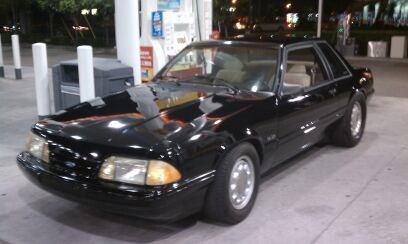

Well after just about finishing my 89 FHP coupe, 5.0 vortech S trim, 5 spd, 3:73's, Cobra intake, just bought all new a/c components, comp, cond, evap core and hoses and havn't charged it yet I've decided to do an LS1 car again. I miss my old one. What did it for me this time, I went to the track and the dam car is so heat sensitive due to the supercharger I had to wait to make frickn 3 passes due to a line of cars. Pass, wait to cool off, pass again wait till cool enough and just not fast enough for a power adder car. My LS1 car I could make pass after pass with no cool off period even with the a/c on. leave in drive, a/c on and run 7:40's with 235/60/15 tires.

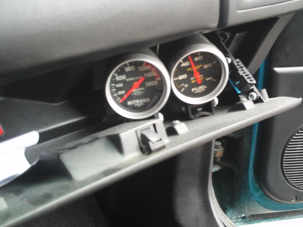

only gauges in car, rest was factory gauges that all worked
