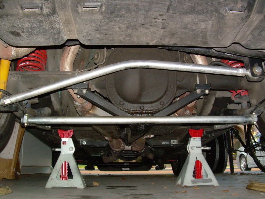

I had the front tires chocked, and the car jacked up under the torque arm so I could change the fuel filter. I went to get my jackstands and WHAM the ############ of a jack squirted out from under the torque arm and the panhard bar caught it as the car fell. Yes, that bent bar is supposed to be straight. Track event coming up Saturday. No way to get a new bar here in time. What's an enteprising fail-jockey to do? Dismount the bar, turn it upside, down, and jack it up (mostly) straight again, that's what. ####er.

I appreciate it but I think I'm good for now. I got it mostly straight, and since I'm only running street tires I don't think I'll be generating enough load to bend it more. I'll secure a replacement eventually.

Those are Maximum Motorsports adjustables, and I dig the hell out of them. As for the bar, I could sleeve it for now, or get another one cut and threaded, but I'll just get a replacement bar from MM and not worry about it in the short term. I'll get a pic of how it looks now, later on.

The jack that slipped was a low-profile aluminum jobby with a (slippery, oil-soaked) pad in the middle of it. I have always just placed it under the flat portion of the TA with never a hint of slip. This time, no luck. So I hauled out the giant 2.5 ton steelie I have, and placed its saddle so that it cradled the TA under the weld where it transitions from the flat rearward portion to the angled forward portion.

I was wondering, when the LCA is curved like that, does it affect the anti-squat / instant center? I'm guessing "no" (because the fore/aft pickup points are unchanged) but WTH I'm no physicist. . .anyone?

It wouldn't matter if they were pretzel shaped, as long as the pickup points are located in the same place, so the LCA's themselves can't change the IC for any given ride height. You need to relocate the pickup points with different brackets in order to do that.

Nope, straight line between 2 points is a straight line (even if its curved...)
