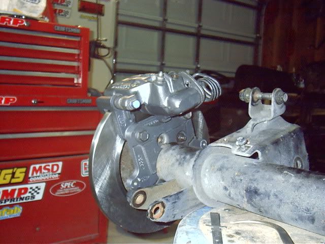

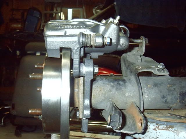

I'd already bought the North Race cars Cobra conversion brackets to use on my GT, but also wanted to use ranger axles on the LTD. The SN axles are a little too long and spaces the tires out so they rub with passengers and a full load of fuel. After trying to figure out a way to cheaply make the stock SN brackets work I think this may work. I took the right caliper bracket and cut it to use on the left side of the rearend, and vice-versa with the other bracket
I mounted the bracket's flat side to the backside of the rearend flange and mocked it up to see how it would fit. The spacer between the brackets is what came with the Cobra brackets I'd ordered. I may need to get one that is slightly thinner to center the rotor in the bracket

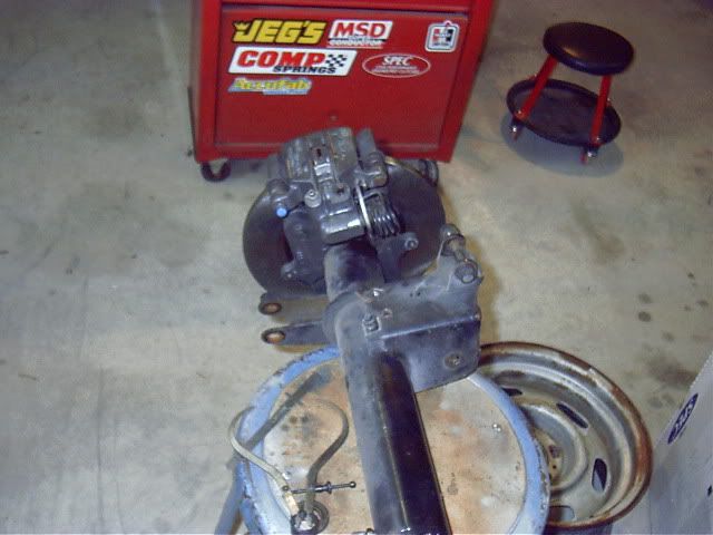

The only thing I'm thinking may be an issue is there's now two bolts holding the brake part of all this to the rearend versus 4 that it had before. But the caliper has two bolts holding it as well the main bracket. I may drill the two holes to put larger grade 8 bolts or come up with a way to tie the two halves together. Here's some more pics:
I should add that since I first did this I've just cut the bracket so it is like a horseshoe that slides over the backside of the axlen flange. Once it is on and bolted up I weld back in the little piece I cut out. It's been working great for many years and miles on the I think five cars I've done since I started this.

Looking at the pics again I might have been better off to cut the brackets this way instead so all four bolts would still be supporting the entire bracket. Just make sure it is oriented right when you cut it so that the cut is at the bottom when it is installed.

which "spacers" are you talking about and where are they placed? you said they came with the north cobra brackets but i cant see them in the pics.
They are actually washers that came with NC brackets. Only used to align the caliper so it's centered on the rotor. Look between the caliper and bracket on the second pic.
