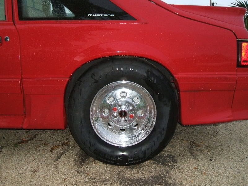

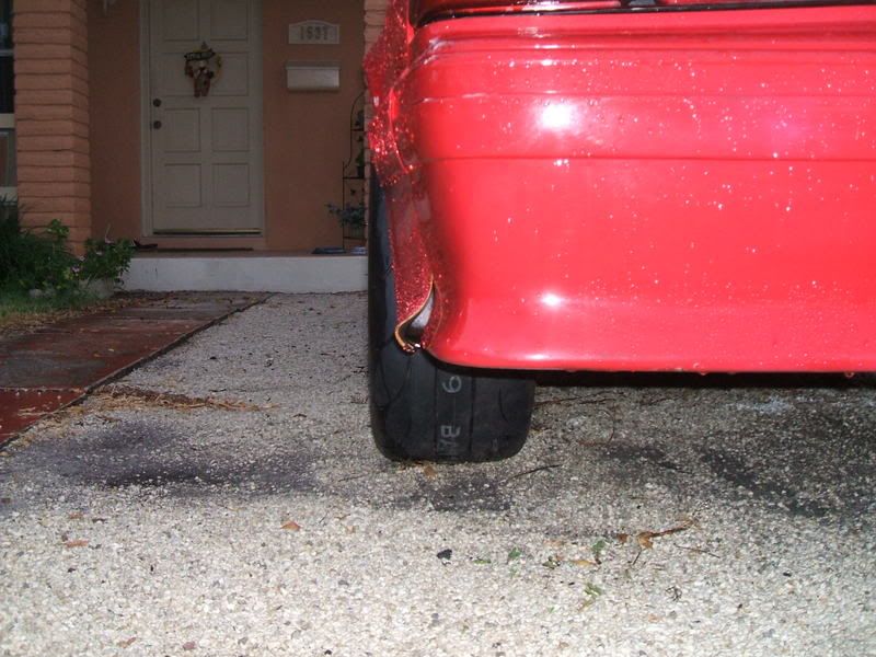

So I threw on the rear wheels to check clearance in the wheel well and here are the results...
I think a simple fix to the driver side rubbing would be to add a spacer. I'll update once i throw one on.

Why dont you just take off the quad shock.

I am really green when it comes to this, but couldn't you just flip the shock?
Yes, that's exactly what you do. Or just remove it.

Throw the quad shocks in the garbage and forget about them. That is the first thing I do when I purchase a stang and I own quite a few now.
You really do need to either roll your fenders or have someone do it for you.
We run the 275/50/15's on 5 or 6 of our cars and the 275/60/15's on maybe 4-5 and we have no issues with any of them with the fenders rolled.
The 275/60/15 will clear stock style suspension with no problem if your axle is centered. Most will work if you just take the quad shocks off which are useless any way.
