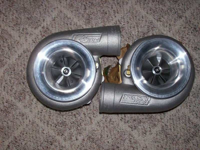

single PT78 with .96 exhaust housing. Turbo will support 1200fwhp. Personally I am a fan of the twin setup. Just like others stated spool easier and just plain out cool. We are putting twin pt74's with .96 exhaust housings on my coupe. Here is a pic of them

if you are speaking to me about the pt74's we are a precision dealer. I can get you a price for them. I need to know what inlet you want. Those are bellmouth turbos.
