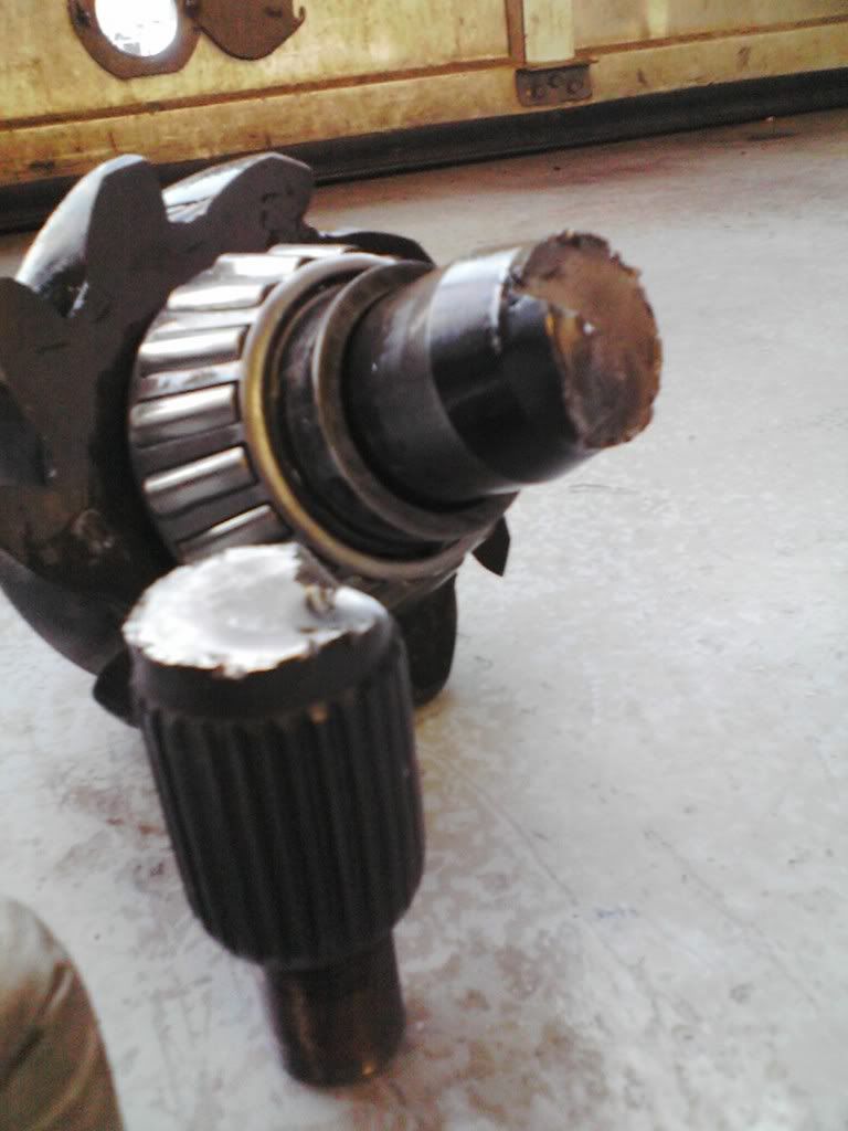

Looks like the TT notch has yet another ailment. This time not headgasket related. Giving the car a "test" on the street yielded a loud bang when in 3rd. First I thought it was the driveshaft. But seeing the pumkin cover gashed down the middle made me think otherwise. Not sure what went. Autopsy to follow soon.
Erich

Not the autopsy but here is what I mean.

Looks like it was either the spider gear or the pin. I was worried that the bolt holding the pin in had come out but no. You can still see a piece of the pin in there. Overall, it does not look bad in there. I wounder if it would be possible to just replace the posi and spider gears and give it a clean up?

These are all going into the broken parts hall of fame. The cover has to go on the wall. The broken gears and shaft are at work on my desk.

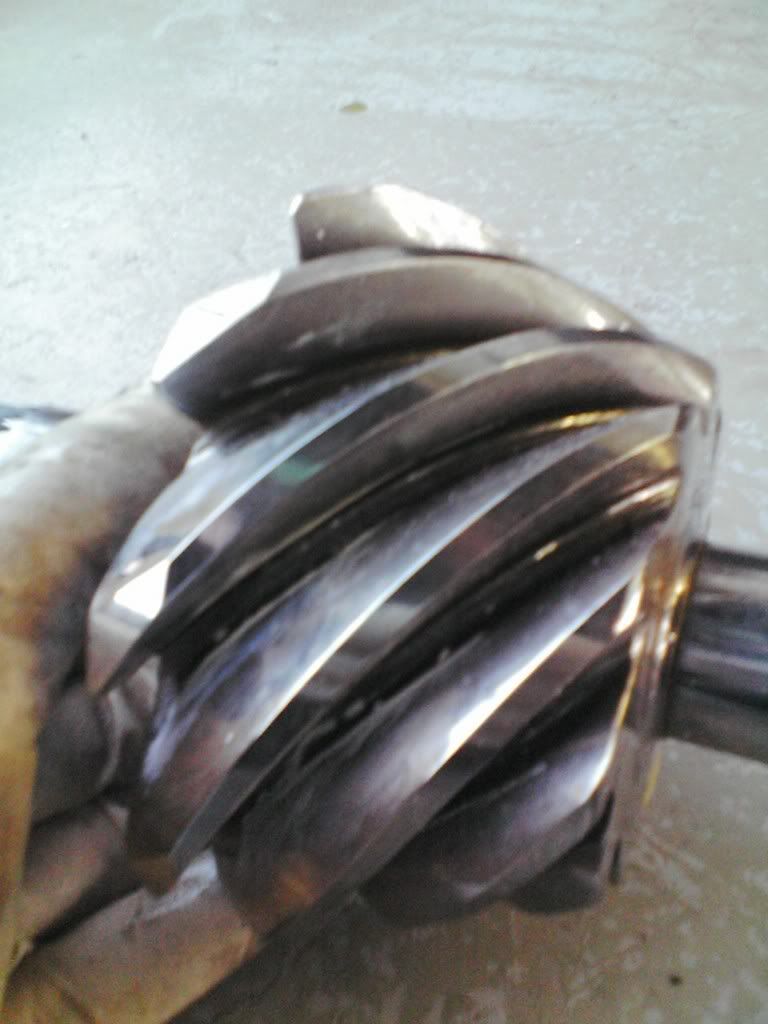

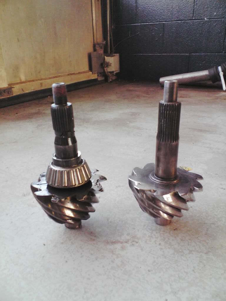

I've had A LOT of issues lately trying to find quality gears. I just had to re-do my last ring and pinion job for free. I used a Moser brand ring and pinion and spent a lot of time setting it up totally to spec. I even went out and bought a $400 pinion depth gauge, just because it pays to be dead on when you are doing gear swaps quite often. I drove the car down the road and took it back to the guy, it was nosier than hell. I took it all apart, and put my old Ford Racing 3.55 in there for the guy and gave him the gears for no charge, they are quiet as can be. ALso, like I said in my earlier post, I snapped my Moser 9" pinion gear in half a few months ago.
Long story short, when you change your gears again, make it the last time and buy a quality gear like Richmond or Motive. Ford Racing gears are made by motive, and thats what I usually use now.
As for my car, I found a website thru a guy here at work who is on a Busch team's pit crew called www.2ndchanceraceparts.com. I picked up a Richmond 3.40 ratio gear from Bobby Hamilton Jr.'s car that has been shot peened and micro polished. It only had one race on it and looked perfect. I got it for $100! Here are some pics:
Difference in quality, Moser vs. Richmond (look at the thickness):
Broken pinion:
Polished replacement:
