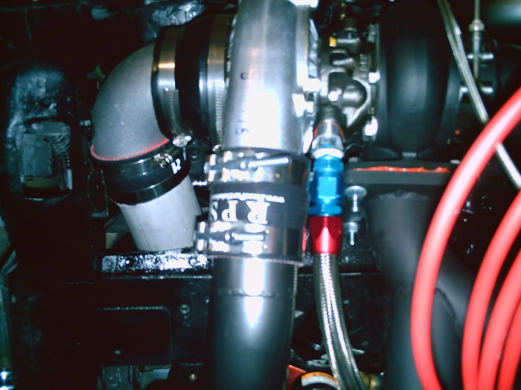

I just recently switched from s/c to turbo and took her out today for a little drive. First drive it started backfiring and idling high and getting hot. So i bring it back and a plug wire was off and I was in the process of adding coolant so it was low..so I topped it off. Put the the plug wire back on took it for a drive everythign seemed ok then. Staying nice and cool but it started to kinda pop and back fire a little. Not like loud but little back fires if that makes sense. It would happend when i give it any throttle I havnt tried WOT yet because its not tuned so im not sure what it would do then. Im going to double check the plugs again and take it for a spin tomarrow but I was wondering what sorta things might cause this. Im hoping its just a bad connection with the plugs. My vacume is good to.

Could be plugs or wires, also might be running lean. What is your fuel setup, including FP, and do you have a wideband on it? Also, what is your timing set at?

timing at 10 initial (stock) fp at 40 i use a dyno for my a/f at the moment.

um its right.. its poping a just idle.. im really thinking its wires.. i added some FP andpulled a degree of timing. I reset the computer and goin to see what that does. Then im going to play with the wires while its running.. only now pipes get so hot and are in the way alot ..makes it harder now lol

Took all the wires off and tested them there all good and i made sure they have a good connection.. still popping and stuff at part throttle.. it seems to go away when i get in it some. But just slow acceleration it pops is annoying. I tried adding fuel did nothing but make my plugs black as ####. Anyone else have any ideas?

hmm sounds like you need a tune, if you are using a SCT chip with a previous tune, it will be probaly nowhere close, remember your going to a load based power adder unlike the centrifical supercharger, that relies on rpm to make boost, and are u using a blow through mass air meter, or drawthrough ? that will make a big diffrence due to mass air transfer units designed to mesure air, im going to PM you.

Like erich just said, if you went from a draw thru S/C to a blow thru turbo setup then your transfer function is WAAAAY off.

when you say transfer function what do you mean?.. I guess im goign to switch to blow through.

All of the quicktime turbo kits are blow-through. I had the same drivability problem w/ my car. I am using the tweecer to tune and what I have been experiencing(and probably you) is a lean tip-in/part throttle cruise. Currently I have mine sorted out fairly well. The best way to tell what is going on is to have a wideband on the car when the problem is happening. As far as transfer function he is meaning the actual MAF Flow #'s that are entered into the computer.
Also If you are using your S/C tune it will be off. I have tuned my car and a friend's car w/ a s-trim. All that i can say is that his car was a breeze to tune and get dialed in(drives like stock) and mine has been a bitch the whole time.

could it be something with your 02 sensors?? They ( @ close loop) would try to get a 14.64 AF at idle, it sounds like your going lean. This is assuming its not a bad connection or timing issue.

It shouldn't be that hard to tune it with a blow thru set up. I've done both and had great results either way. staticstang, what meter are you using?
slo5.0 as static stated you will need to get your current chip retuned, get a dyno tune or get something like a tweecer to tune it. I will caution you that if you don't know what your doing with a tweecer you don't need to go that route.

If i got witha blow through instead of the draw through I wont need to mess with anything as it should be pretty squared away. Being as how the kit is made for that.

If you have the Quick Time kit, it is a blow thru kit and there is not room in front of the turbo to make it a draw thru. You will still need to have it tuned. You can get a PMAS meter set up for blow thru and calibrated for the injectors you are using and it should run fine but it will still benefit from a dyno tuned chip. My Q/T kit is in route to me as of today and it will be tuned.

It will have to be "fine" with the blow through calibrated for the inj. Its already been chipped. I will be tuning it as best as I can on the dyno with FP, timign/boost. And as for there not being room.. thats bull because im currently running draw through on a QT kit

look closely for any leaks after the meter and before the t.b.
i don't think your issue is a blow through draw through issue. but you have alot of couplers and connections after the meter that can screw up the mass air meter reading. meter should typically be 0.6-0.8 at idle, check that first. very lean idle can cause what you are having which could be caused by a leak or a bad meter.
check all your piping 1st. blow off or bypass? if blowoff, is it leaking at idle? then borrow a meter from a friend.

1.how does a lean at idle cause black sooted plug's?
black plugs = rich condition ,lean = very white, possibly burned off plug straps
2. rob are you using a drawthrough or blowthrough meter?
im just curious
3. this is comon knowledge, if you use a open atmosphere BOV with a drawthrough meter, you will encounter a highly rich conditon under closed throttle coming out of boost due to the engine not actually recieving the metered air , which could cause stalling, fouling plug's ,rough idle, stumbling ect,
A CBV (by-pass valve) must be used as being a closed system, any loss of air for which fuel has already been metered by the movement of the airflow sensor plate, will result in an over-rich condition and possible backfire. A CBV is found on many "OEM" original engine manufactured EFI turbo systems.
A BOV(open atmosphere) is suited to an EFI system that uses a blowthrough mass air meter that meters air right before the throttle body or a MAP (manifold absolute pressure) sensor. As the MAP sensor source is inside the inlet manifold's plenum chamber, relieving air before this with a closed throttle butterfly (throttle lift-off) will not affect running.

1. after reading his post again, he said black plugs when he added pressure, so its not lean.
2. i ran a blow through setup with a c&l meter than a pmas pro tube meter. though crossed my mind to convert to draw through. sold the hellion and put the vortech back on a few weeks ago and ordered a quicktime setup 2 weeks ago and will be running a ba2800 blow through setup which i tune myself with sct software.
3. i asked, blowoff or bypass because i don't know what he's running. has anybody run a draw through mass air setup on a mustang with a blow off? i would guess yes.

To answer robs ? the only thing I think that could be leaking is the BOV it has a 6 lb spring i belive and i think with a bigger engine a friend was telling me that it will leak at idle/part throttle.. honestly im not sure exactly. Havnt looked into it that much.

his kits come with tial 38mm wastegate and 50mm blowoff.
it is highly unlikely that his idle problem is caused by a leaking wastegate
now a leaking blowoff on a drawthrough setup could. my mitsubishi blowoff leaked a little at idle, but it was blow through so idle wasn't effected.

I guess i could remove the vacume at idle from the BOV and find out if its leaking because my popping at idle would go away wouldnt it? because woudlnt vacume be whats causing it to open?
