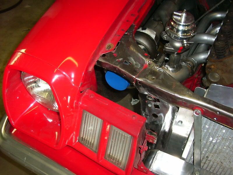

Twin turbo blow thru Pinto mockup done!
The mockup is done, i'll tear it all apart and weld everything up. Then i need to get the rest of the car done (paint/body, interior) The engine is a 383 stroker windsor (351w roller block) the block in the car was for mockup only.

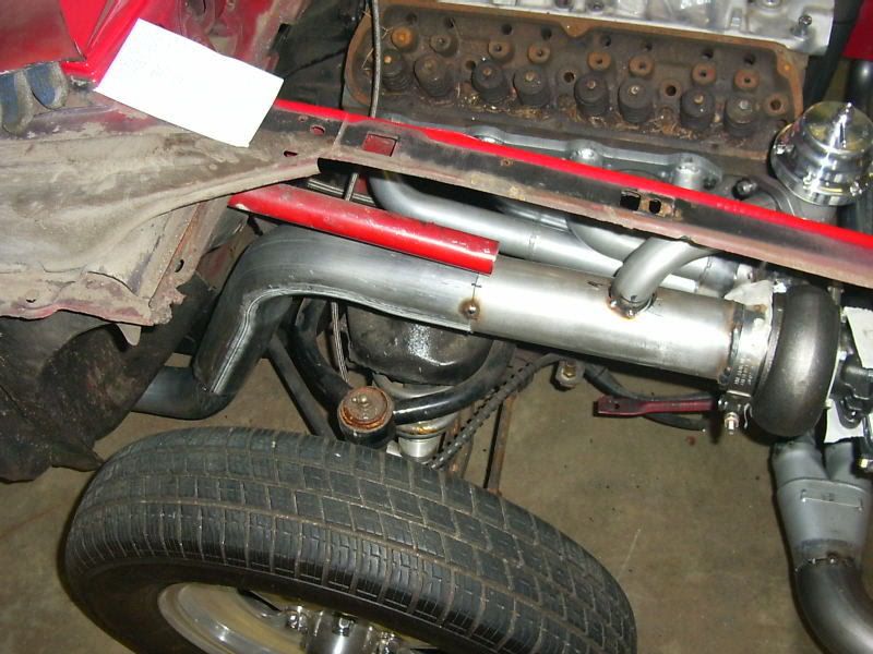

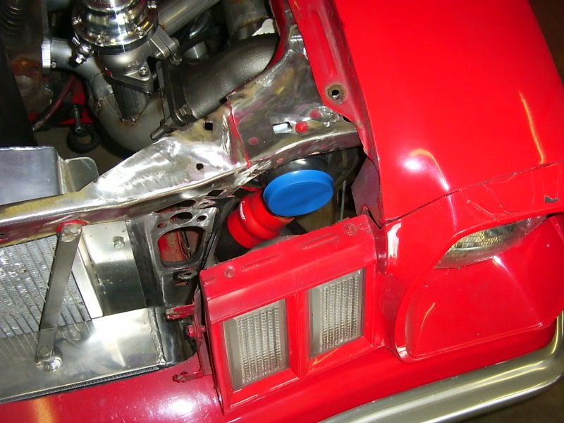

more pictures.

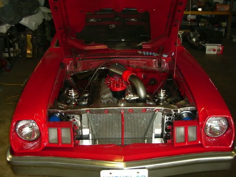

Originally Posted by 10secgoal View Post
Powny down headers modded ? Looks good. Power to weight is going to be stupid.
yup, modded ponydown units. It'll be interesting thats for sure!
This is what my new combination will consist of
'95 roller block 351 with Eagle 383 forged internals
Z303 cam
RHS 215 aluminum heads
Edelbrock Torker II intake (needed shorter intake....don't want to put a 20 inch colw hood on it!)
CSU 750 (powdercoated red) and CSU polished bonnet
Aeromotive A1000 and 13204 regulator and 12304 filter
ponydown '79-'93 twin turbo headers...MAY need to be modifed
2 masterpower TO4E 60 trims with T4 .68 a/r undivided turbine housings
31x12x3 xs power intercooler
2 38mm Tial wastegates and Tial 50mm blow off valve
innovate wideband
AEM tru- boost controller
Built C5 with 3000 convertor (non lockup..C4 convertor and C4 bellhousing)
9 inch rear with spooled 3:50 gears (looking for 3:10's)
pintoman351 is offline
