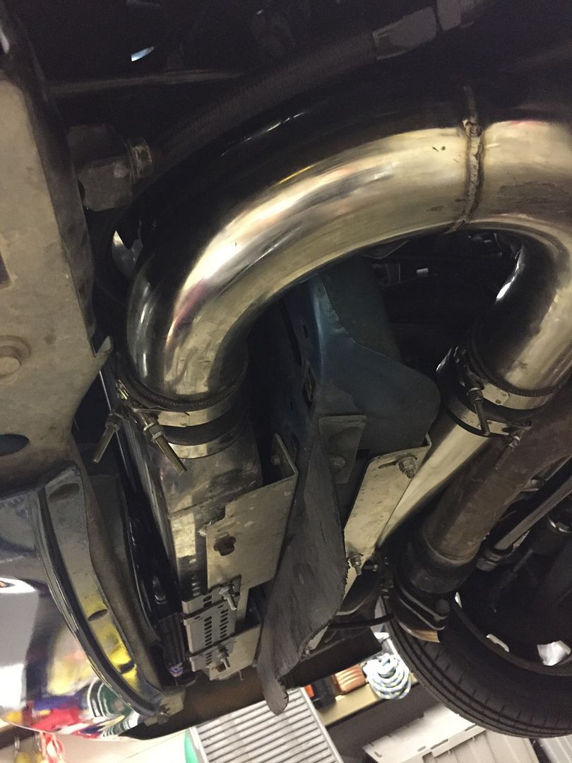

Hey guys having a hell of a time getting my cold side to line up. Does the first charge pipe off the turbo go on top of the lower rad hose or below it jammed up against the crossover pipe?

Jammed. Lol wrap the crossover and let them play together.

Post a pic or 2 so we can help you verify

Some pics
File Type: png Screenshot_20170504-110704_1493906916717.png (1.21 MB, 50 views)
File Type: png Screenshot_20170504-110659_1493906937223.png (1.13 MB, 45 views)
File Type: png Screenshot_20170504-110654_1493906966292.png (1.82 MB, 44 views)

More pics
File Type: jpg Screenshot_20170504-110650_1493907023644.jpg (83.2 KB, 34 views)
File Type: png Screenshot_20170504-110635_1493907052365.png (1.16 MB, 34 views)
File Type: jpg Screenshot_20170504-110645_1493907071722.jpg (79.0 KB, 31 views)

yeah, looks right to me.

I cut 1" of the U-bend from the pipe in your picture to the input into the intercooler.
Pulled that cold side pipe nicely away from the cross over.
Not a great picture, but you see what's going on.

If you can try to raise the intercooler to a level just below the bumper. That will close your gap on the MAF tube and should allow you to rotate the charge pipe forward slightly. I just finished a kit on a 93' cobra. There were not many tubes that I didn't end up modifying to get the fit I wanted.

Thanks guys ended up raising the intercooler just about level with the rad support and cut 2" off the intercooler side of the pipe with the MAF in it. the last pipe that goes into the 90 to the throttle body is still a little wonky but I can live with it for now.
