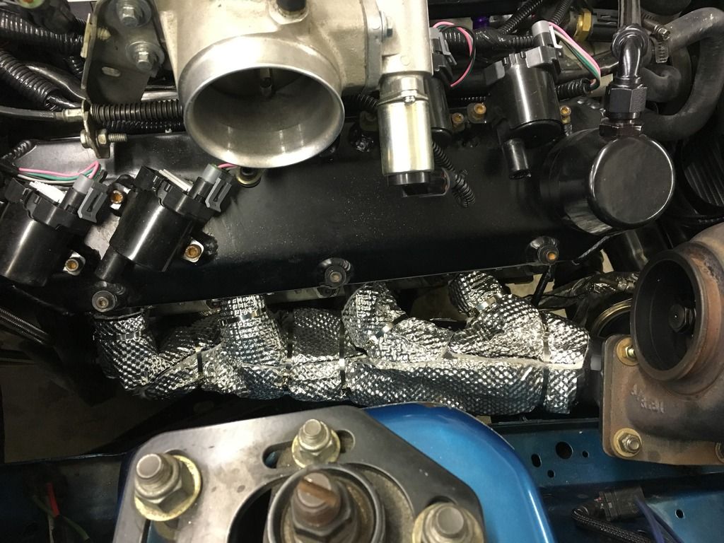

The Bud Light heat shield adds 10 horsepower..

LOL!. That pic is from my old setup. pipe was a bit close to the Rad hose and that pipe gets RED HOT! had it melt once on the dyno but the Bud light can fixed that!
Coolant hose melted but the plastic zip-ties lived? That pic must be in 'mock up' I would think?? Using stainless bands now?

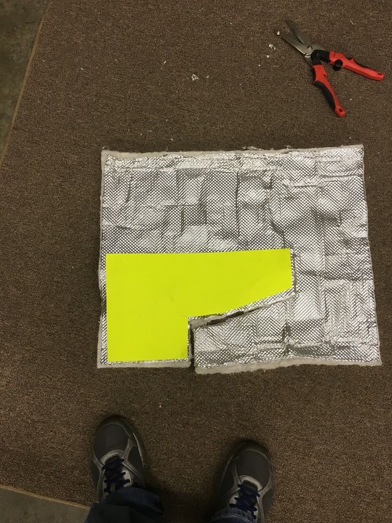

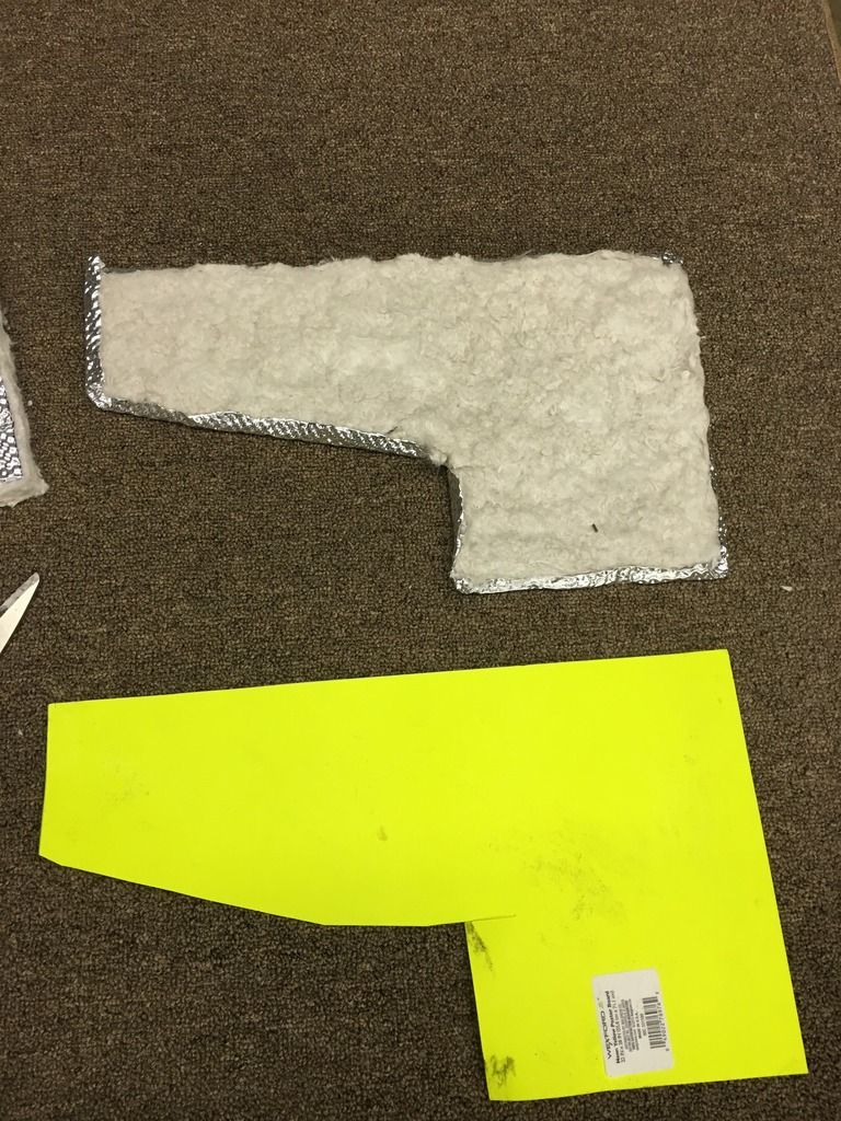

FWIW, I've found almost exactly what OEM manufactures use for heat shielding. The company is actually called 'Heatshield Products' and this crap works! Buy a roll of their stuff and let your imagination run wild.
That's nice stuff. Thanks for the heads up. My hose got soft enough to push a big bubble out. It was ok after the can even with those zip ties. That set up is long gone now.
Cool man. It looks factory.
