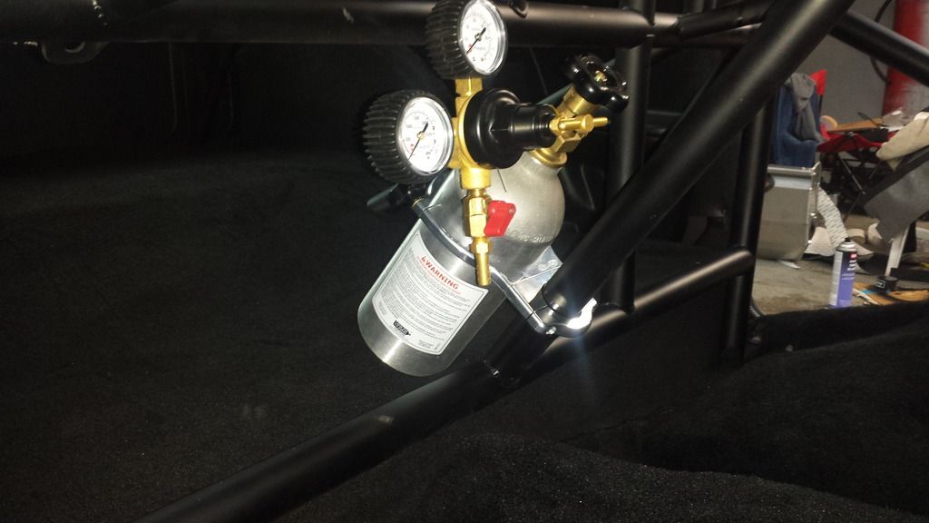

post #8 of 8 Old 04-19-2016, 01:41 PM Thread Starter
TomR's Avatar
Join Date: Aug 2009
Location: Macon, GA
Posts: 4,947
I'm making a bottle holder out of 4.5 inch ID 5 inch OD 6061-T6 aluminum tube.
I'll use dual regulators, a high side regulator for the shifter and a low side that feeds off the shifter pressure regulator to the boost controller.
