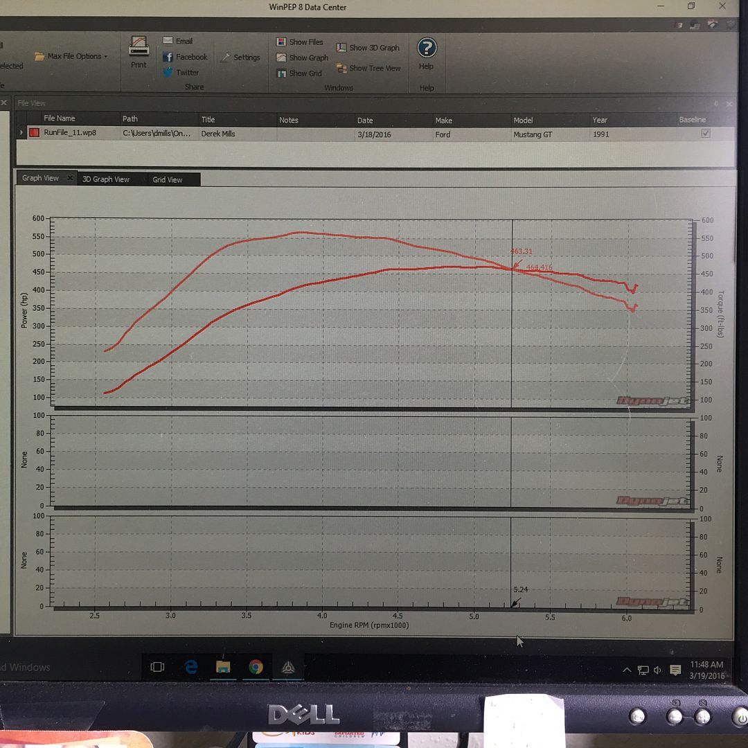

Finally Dyno Tune Complete: 480HP/575tq ???
So looking for advice on what, if anything, to change on my combo.
I bought the car with F-cam, Vic Jr. heads, Edlebrock Performer (yes the very old one) intake, 3.55 gears, and a crappy Treadstone 76mm turbo kit. Shortly after putting some real miles on it the cheapo SS headers developed 3 different cracks. Rather than weld them up, I decided to replace the turbo kit with components I selected myself.
I talked to 3 turbo vendors, they all recommended something different in turbo size. My goal was to push the stock block, and have a fun street machine with maybe a couple trips to the track to see what I can do with it.
In the end, I got what sounded like good advice, and went with Comp turbo 67mm, triple BB, billet wheel turbo. The advice was, you want the smallest turbo that will meet your needs. My needs were 500rwhp and fun on the streets.
Fast forward to dyno today. On 10lbs boost it made 480HP and 575TQ. The difference between HP and TQ is crazy to me. Looking at the dyno graph I would like to flatten the torque curve out some and raise the HP some.
Would an intake change accomplish what I am looking for? I think the Performer is the weak link in my combo but I know it is good for the street.
Take a look at the graph below and let me know what you think. Is the quick TQ peak and then drop off, accompanied by the HP curve and indication of the intake being a bottleneck?

post #2 of 31 Old 03-19-2016, 12:08 AM
Join Date: Jun 2015
Posts: 378
I'm no expert or now much about tunning but hp and tq are suppose to cross at 5252rpm and it looks like yours is at 4300ish rpm. Something is not right.

post #4 of 31 Old 03-19-2016, 09:05 AM Thread Starter
Join Date: Jun 2014
Location: Crystal City, Mo
Posts: 204
Yeah you are right. I thought they were always supposed to cross at 52xx. I'm not sure what to do at this point. I guess i can call them and ask about that.

hp and tq always intersect at 5252 rpm, its simple math.

OK as indy stated, so my tuner did also. After talking with him explained that the horsepower and torque scales are different. Loving my tuner by the way, who helped me out with showing me how to scale it different and the result is the following graph.
So back to the question, intake swap in order if I want more power under the curve?

Originally Posted by dmills4229 View Post
I hear what you are saying but won't that just give me the same shaped graph, the difference being that the numbers will be higher?
I'd like to see horsepower keep climbing, and torque be flatter. If I'm thinking about this right I could make a combo change to reduce the low-end torque and gain high end horsepower.
His tuner is correct. HP and torque lines on a graph only cross at 5252 when the absolute scale number of horsepower and torque are the same.
If you look at his graph closely, you see HP=TQ at 5252.

is it me or does the op's torque fall off rather fast
I agree. Especially when a previous dyno run, albeit with 11.5lbs of boost vs. 10lbs of boost, showed a much flatter torque curve. On that run however the clutch started slipping and so I'm not sure how trustworthy the data is.
Came back later with a new clutch, and 1.5lbs less boost, and got the posted run. Exact same dyno.

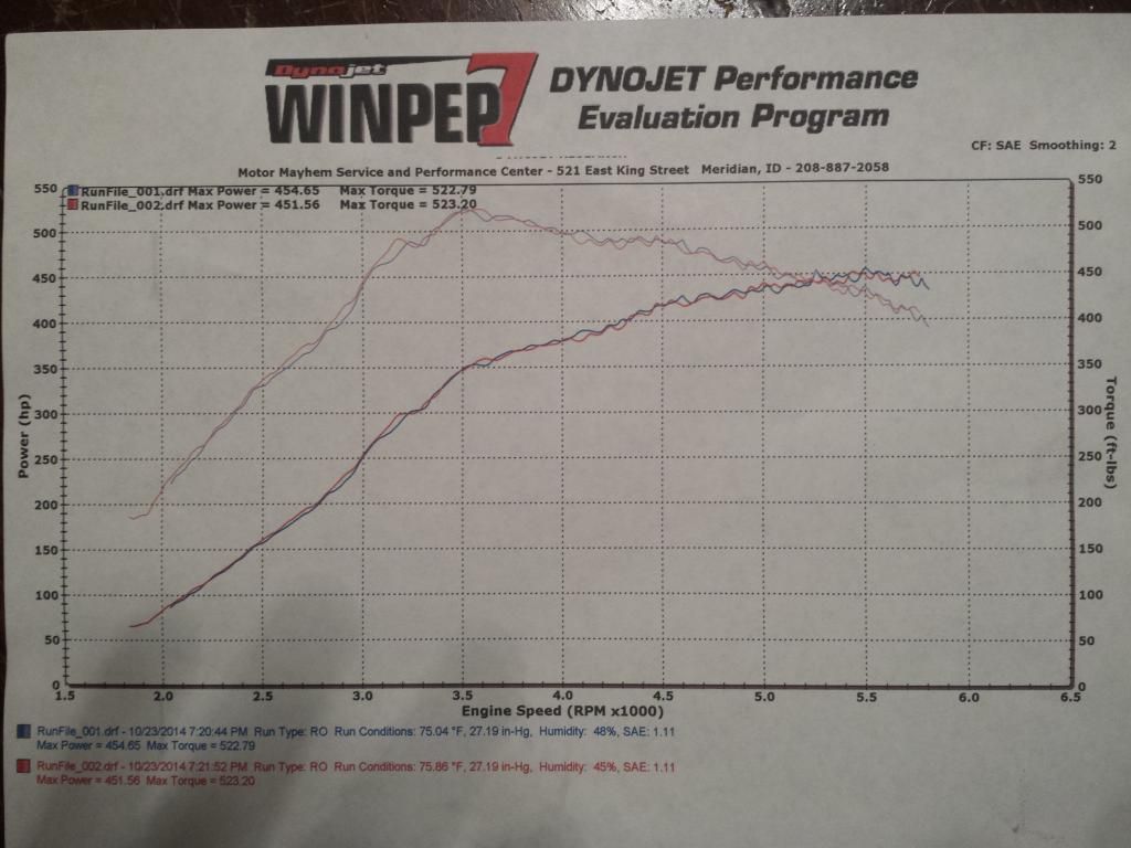

Since we're sharing similar combo's. I figured I'd throw mine up too. Stock Explorer short block. TFS 170 heads. F cam. T-moss ported cobra intake. On3 CBB 67mm turbo at 9 psi. I love the love end grunt. Makes it a ton of fun on the street.
Wow similar combos and very similar results. I'm running a Comp Turbo 67 BB.
