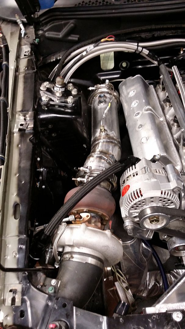

Has any body done a 4" down pipe, if so please send pics, looking to reduce back-pressure. BTW 8.2 based motor.

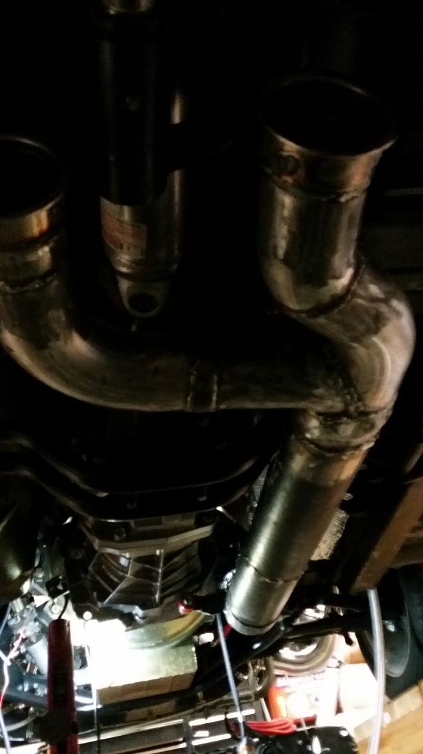

4" from the turbo to a "y" at the tail of the transmission. there it splits into dual 3" over the axle and out the back.
my hotside is originally a BG Custom kit that had a 3.5". I made the 4" myself. I'll get some pics up later.

I have a wrapped 4" (makes it about 4-1/4 OD) on passenger side and down to a split where it goes to dual 3".
No notch required.

Could you by any chance snap a picture of you going over the axle with it? Im trying to figure out a way to get my 3.5" single over the axle but I dont see a decent route. Thanks

I have a panhard bar and a large aluminum fuel tank to move around and still clear 315 tires. Probably different setups. That and I am only running 3 inch pipe. There is a thread in the general forum here under lightweight aluminum exhaust thread. I have a bunch of pictures in there.
