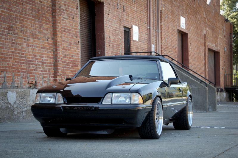

Have any you guys tried this piece . I think i'm add this also .
Clean up the front end of your 87-93 Mustang with the LX Mustang Grille Bar Eliminator. This kit will instantly make your Mustang's front fascia look sportier and cleaner while providing a larger opening with the elimination of the grille.
Installs easily with basic tools in 15 minutes (not including paint).

Ive looked into them at several pictures on the net and just had mixed feelings about the way it looked. I'm sure it would help more airflow but it kinda looks "ston on" to me. I hate that you can really see the lines after the install
