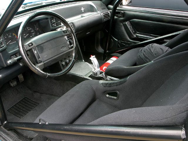

I just ordered a Hurst quarter stick pistol grip. I'm going to do this:
Also looks good with a boot...

yeah I'm going to do something along those lines too. The guy I got my transmission from tossed the B&M Pro Stick in with the transmission since he wasnt going to need it.

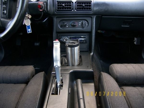

Hurst quarter stick here in the ash tray location.
Any pics?

Originally Posted by TxFireman1972 View Post
Any pics?
+1

Ill snap a pic tonight.
