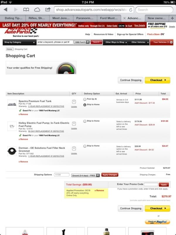

1. Is this the fuel pump I need?
Holley
Part No. 12-915
Avenger; Forced Induction Series; Performance In-Tank Electric Pump; 255 LPH
Electric Fuel Pump; In-Tank Electric Fuel Pump; 255 LPH; Forced Induction

The tank leaks when it's full and drips down the back. Anything else i need?

Instead of buying a new tank, figure out where yours is leaking from. It sounds like it could be from the fuel neck rubber grommet. As far as the fuel pump, it sounds like a standard Walbro 255lph will work for what you're wanting. They're only about $100. I would go ahead and pick up an adjustable fuel pressure regulator as well, that will help get your fuel pressure set correctly when the car gets tuned.
