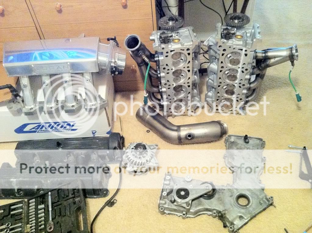

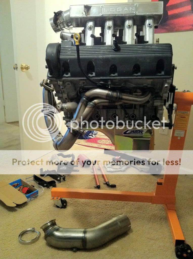

tore into everything and took the block to the machine shop today
[IMG][/IMG]
[IMG][/IMG]
Having the block cleaned, honed, decked, and checked completely.I have a pair of upgraded timing chain tensioner pivot bolts. So the holes for them are being drilled and tapped to accept the larger size bolts. Ill order the pistons next and the bearings.

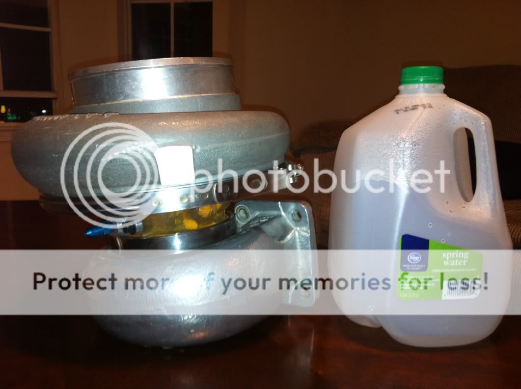

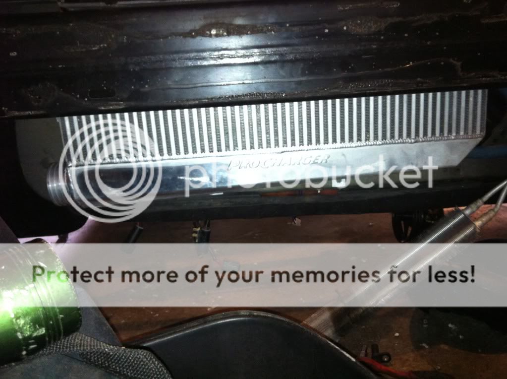

Stepped it up a notch today.....Brand new Garrett GT4508R dual ball bearing / water cooled 1.01 A/R....
[IMG][/IMG]
[IMG][/IMG]
going to get that outlet cut off and weld on a proper v band.....ok so maybe not brand new but hasnt been run yet lol
