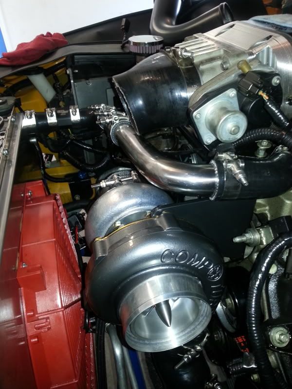

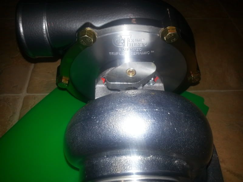

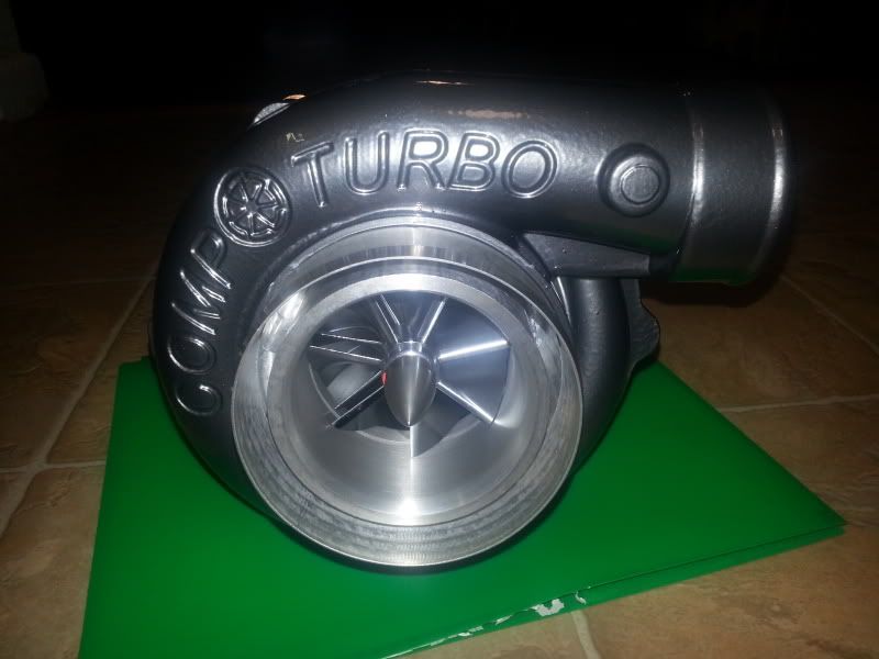

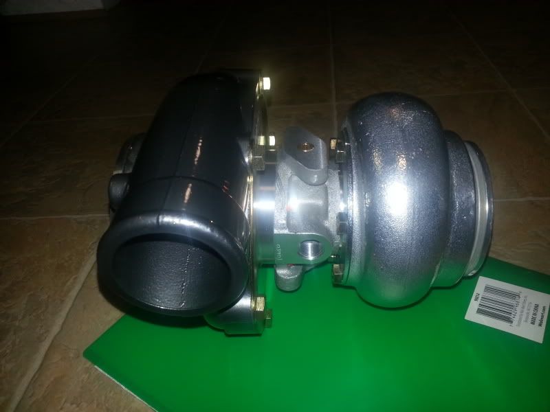

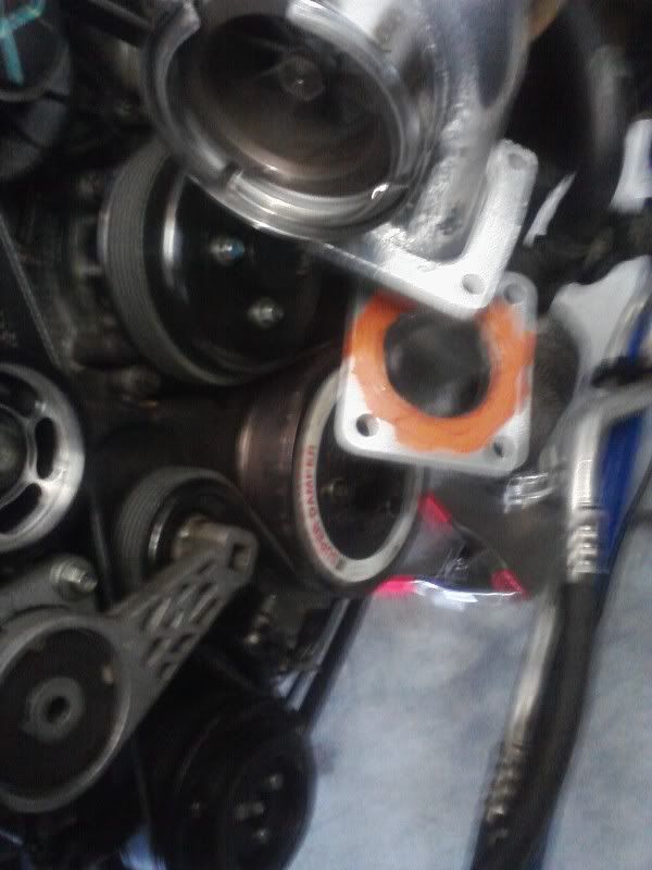

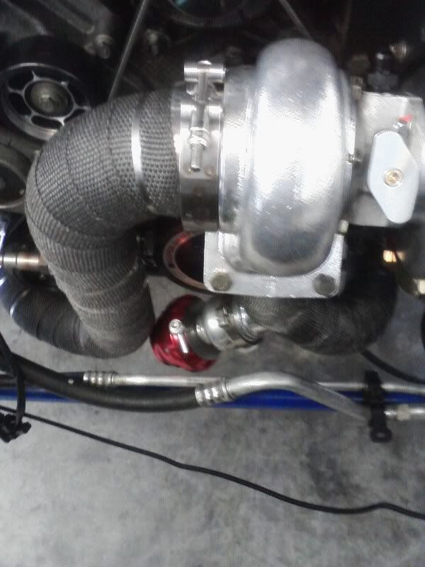

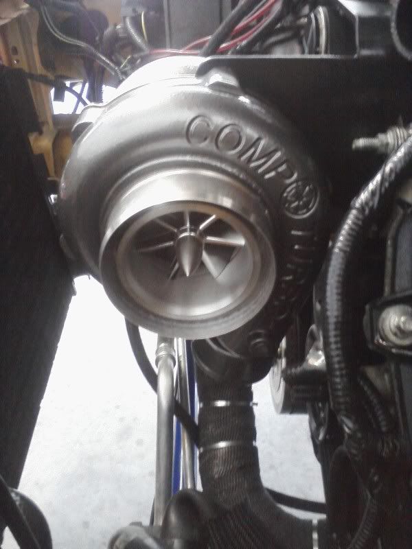

Got her the other day and its already going in the car! And the best part no oil! Water cooled only.
Specs CT4-7068 Ported cover powdercoated gunmetal, billet wheel, triplex ceramic ball bearing oil-less billet chra, T4/3"VB turbine housing ceramic coated silver.
This turbo weighs 14lbs on my scale! My old precision 67 weighed 22lbs.

Thanks guys! Havent been on in a few days been busy putting in long days wrenching on my car.
Im a dealer for Comp turbo's so I got a great price. But for what you get yes they are very affordable compared to precision or turbonetics.
The oil-less setup has a billet aluminum center section with ceramic bearings that are lubed by a high temp synthetic grease. It has larger coolant passages and uses water to cool the center section. This allows you take advantage of thermal siphoning with colder water coming it from below and hot return out from above since you arent limited by the orientation of the chra or moutning location etc.
Whats great is bearing and turbo life are actualy longer than an oil cooled turbo be it journal or bb. There are no seals to worry about and this triplex ceramic bearing setup is 99% efficient so less heat and better cooling with the water. Per Comp for a street car service interval is 3 years/36k miles, service includes full tear down and inspection and regreasing, they also state that having the turbo serviced at regular intervals can actualy extend the life of the bearing system indefinetly.
My car comes out on nice days, and ocasional trips to the track and I maybe but 2-4kmiles on it a year so I will run it for three years then have it serviced. Way better than any oil fed turbos I have had most need serviced once a year or so for oil seals.

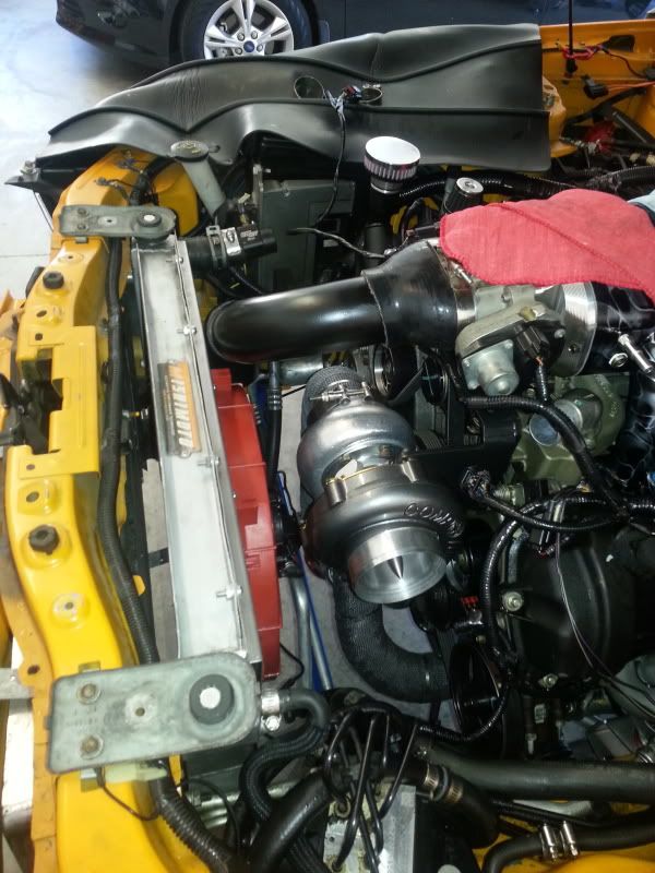

07 GT stock block, stock crank, manley rods, stock bore 15cc diamond pistons/9.1:1 compression, stock heads with comp 127300 cams and springs, arp hardware throughout, Jpc intake, 6060 6 speed. Single turbo 3" maganflow exhaust with maganpacks. Lots of other little goodies but thats the basics lol

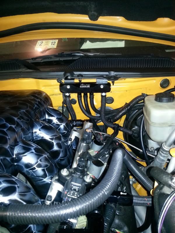

Some more pics.

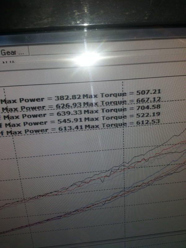

On the dyno!

Thanks! Made 554rwhp 530rwtq at 12psi
And 639rwhp 704rwtq at 18psi Had to let out at 6krpms on the higher boost runs as hp/tq start to nose dive due to back pressure, new hotside has 2.5" piping at the merge to the turbo, going to try and fit a 3" pipe and it should make 700/700 revving to 7k rpms.
