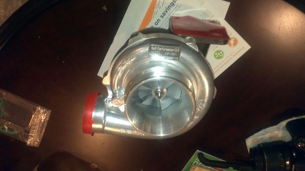

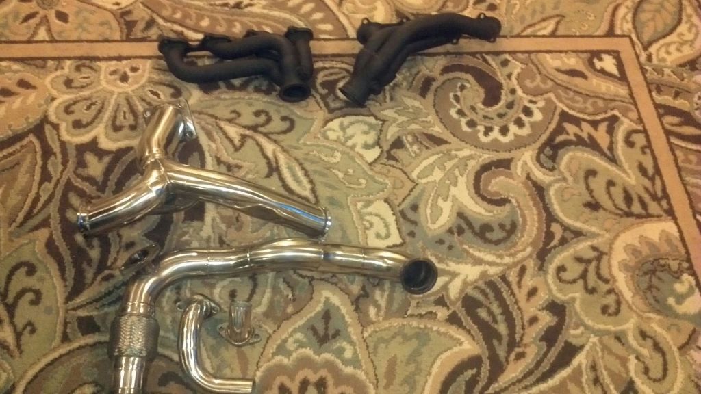

ran by the house before heading to the inlaws for dinner and on the front porch was 3 big boxes. didnt get a chance to open them and go threw them yet. cant wait to get home!!!!! i will post pics tomorrow.

Well opened up the kit and everything is there. The quality seems to be pretty good just looking at the hot side! overall I'm happy so far and really happy it only took a week to receive the kit. Here are a couple quick pics I took with my phone.
