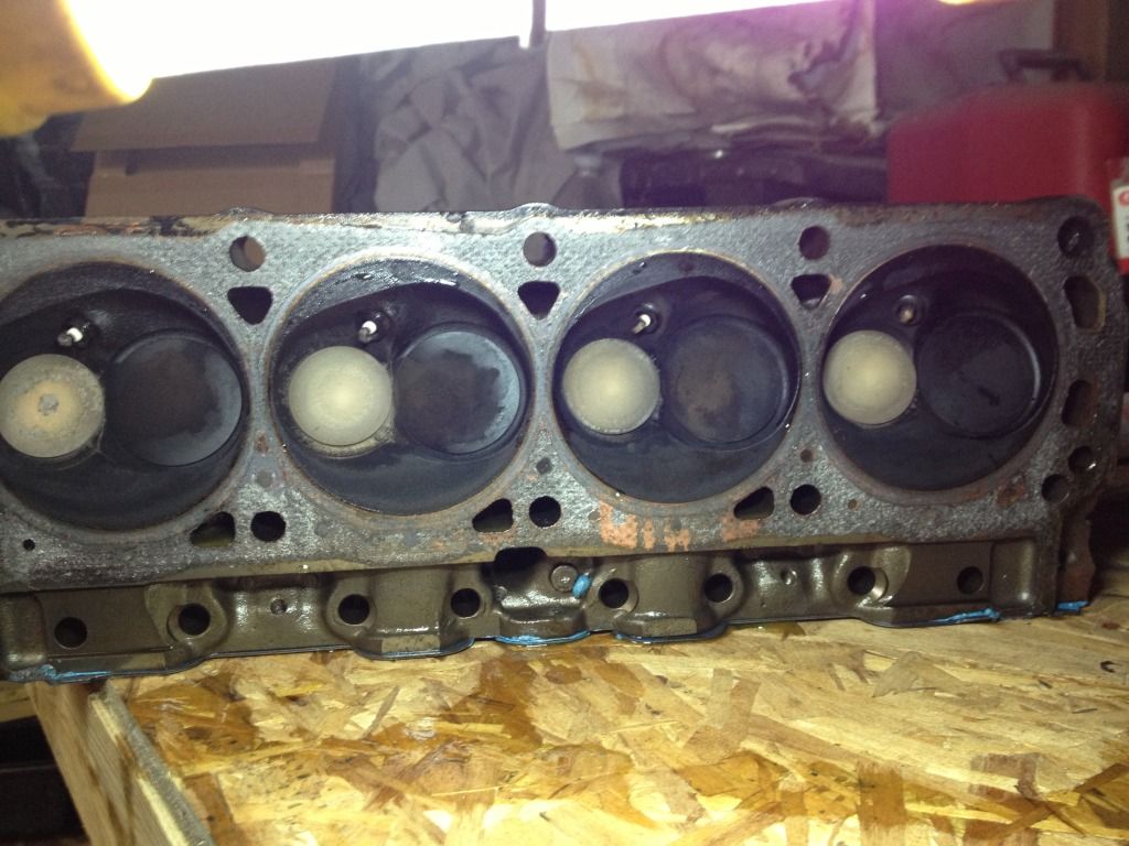

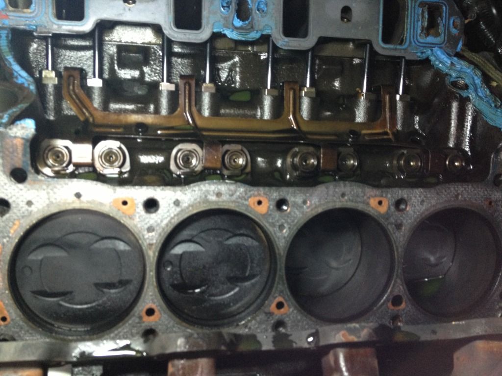

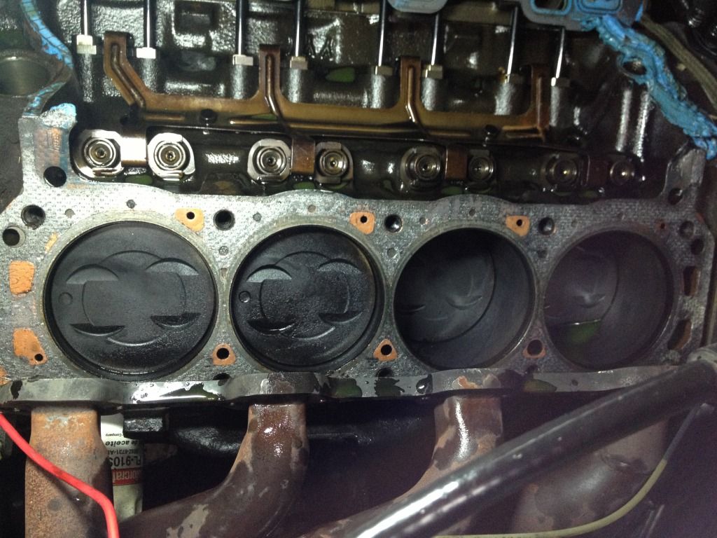

So checked my drivers side compression going from front to back 115 next one header in the way then 125,125. My oil smells like gas but car is running rich. My coolant looks to be good. a little dirty in the overflow but not bad. Oil still appears to be bubbling out of my header gasket but car is not smoking.
048 - YouTube
any ideas?

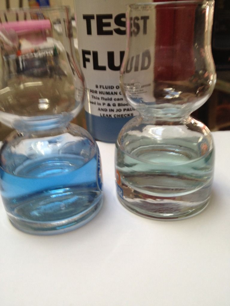

I just went out and pluged the brake booster hose just to check it stayed the same mayb a little more vac added. Then i started spraying my lower intake with starting fluid no results.
Can i blow a head gasket and not smoke out the exhaust? I did hear some bubbling in my radiator. and the one cylinder i suspect is the one i cant fit my compression fitting on

You can buy a kit from auto zone to check for exhaust gasses in the coolant.

Went and got the "block test" and fluid. My results were not as clear as i would of liked. They said the fluid would turn yellow but mine just seem to lighten up. I did it 3x with car at full heat with 2-3inch of fluid out of radiator and i did it once with it full and out of overflow some people said try that way.
Left the blue is the fluid, Right is after 2-3min of pumping radiator air threw it.

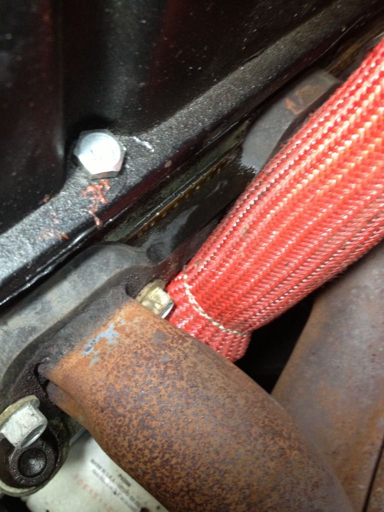

also another video of my mysterious leak from top of header gasket. (header gasket on that side still leaking gasket ordered)
strange moisture - YouTube

So decided to take the heads off well alteast 1 so far the side i suspect. The gasket appeared to be ok. The lower bolt closest to drivers seat was not as tight as the others and had oil leaking around or near it.
So when you take off your heads does part of the gaskets normaly stick to it?
how do they look?
the two pistons closest to driver look clean compared to others.
execlon is offline

from what i see that head gasket looked fine
