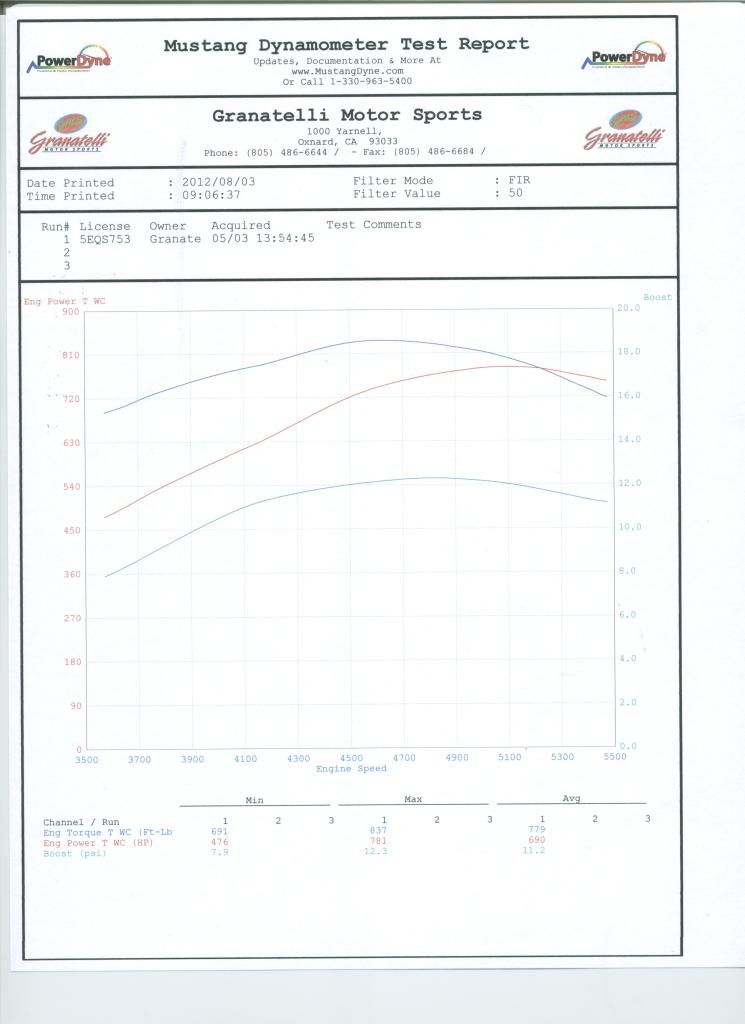

DYNO
Here is the dyno pull
Granatelli is offline
post #4 of 72 Old 07-31-2012, 05:40 PM Thread Starter
Join Date: May 2000
Location: Oxnard, California, USA
Posts: 418
There is the dyno sheet, But we have more, with more boost if you would like to see them.

Do you have a graph that shows boost vs rpm?
justinschmidt1 is offline

Originally Posted by J.R. Granatelli View Post
Look at the average boost, over 11

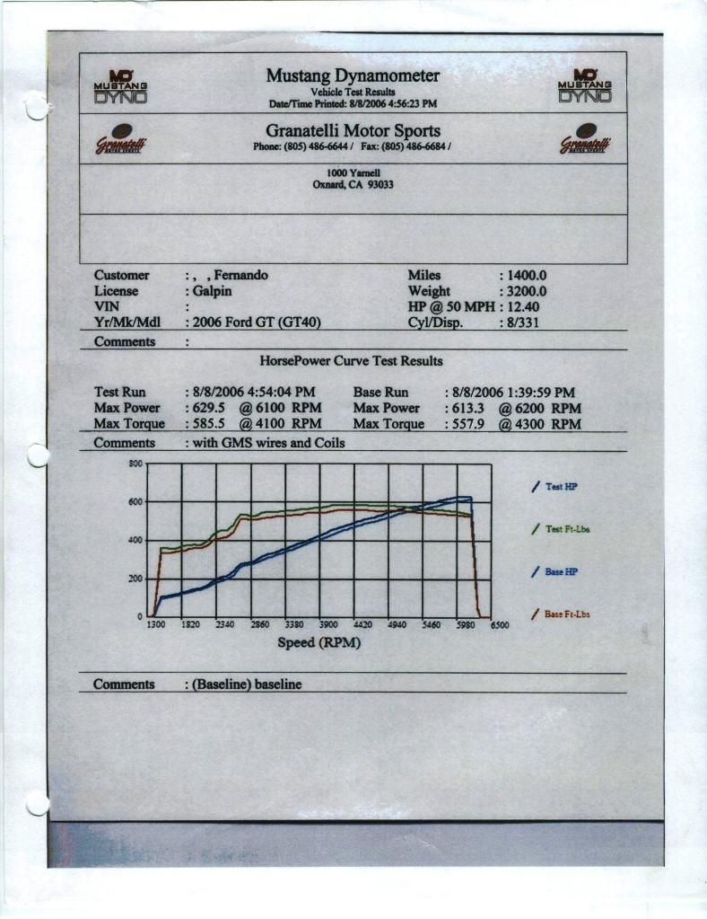

JR, you posted a pic of a dyno graph from a Ford GT, sir.
As for this kit, we had a kit VERY similar to this on our 3V GT. It was a little laggy, but it was also a stick car. It made 480rwhp with the 10lb spring in the WG.
Fernandos car was a 2006 Mustang GT - We did not change the notes on the dyno "note section". That is merely a typo - I put up a ton of info all on 3v turbo kit with 76mm turbo.
