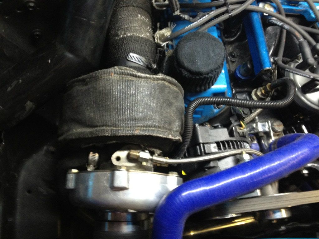

So... can anyone actually confirm who makes the On3 BB turbo? I want to order the 2nd gen kit after tax season (and after I get my T45 built) and I'm in the research phase I guess... I've never really heard of any problems with the MP70 and definitely not the Turbonetics units but if the On3 is something like a "by Turbonetics" unit I'd be down.

Well my car is close to running. Had to fly to the other side of the country for a week but im back working on it and should be making noise this week. Pretty happy with the on3 kit so far, only complaint is that i cant fit a short oil filter on it like mysticsct's car so i had to order a ford racing elbow. (I bought an on3 relocation setup but didnt really like it) any bets on what it will make on the 14 psi spring? :-)

I have a question if my On3 70mm .68A/R turbo goes can i get one of these ball bearing type turbo if so would it bolt right up to what i have now any modifications needed?
Turbo installed!!!!
It will bolt right up. You'd probably have to have it retuned, however.
