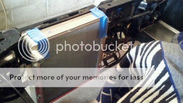

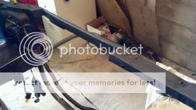

I cut the upper rad support and boxed it in to give me more rad clearance!

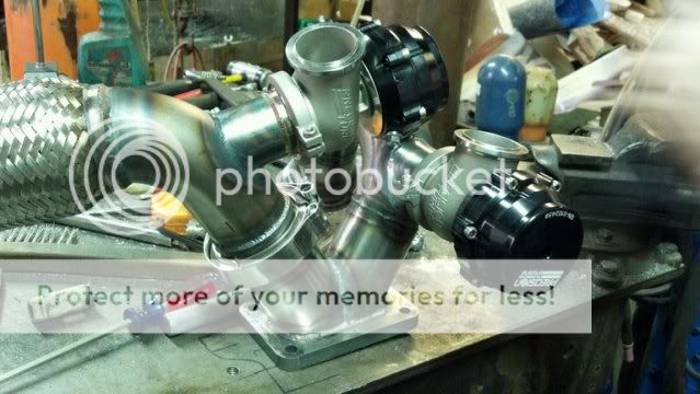

Wastegates!
