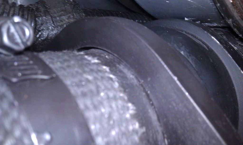

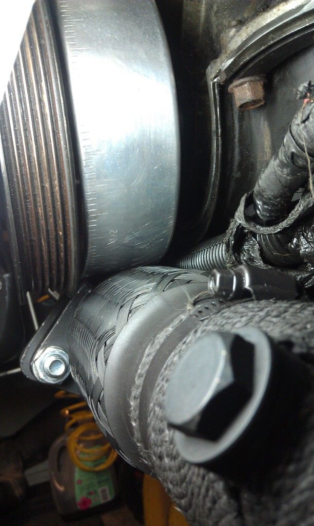

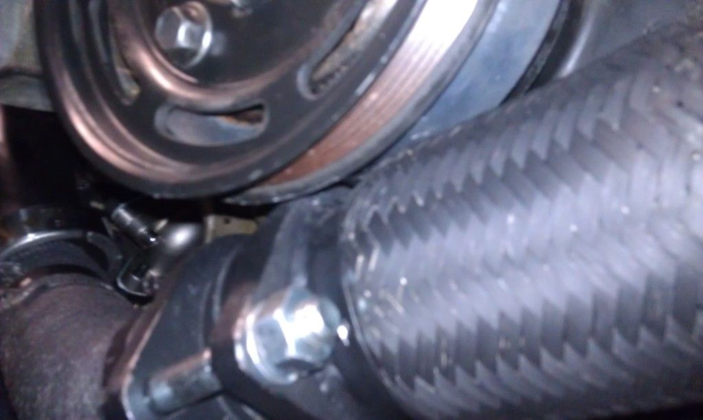

on3 crossover problems....
iv tried moving it every way possible... am i going to have to have somthing made it hits every time i tighten the v bands...
95gt stock

Had the exact same issue with my kit as well. I had to take it to a local shop where they lengthened the passenger side of the crossover and changed the angle. Also, after they fixed that issue, the wastegate no longer hit the vband on the crossover and could be installed with the dump tube facing out. Trust me, I messed with this forever as well to see if I could get it to fit and no matter what I tried it didnt work.

Since the crossover is mounted to the engine and not to the body, it makes no difference what mounts are in it when it comes to the relationship of the crossover to the balancer. Engine moves up, so does crossover, and visa versa.

We have had to deal with this issue a few times, just cut the V-band at the weld on the passenger side of the crossover and re-position it and it will be good to go.

Problem solved thanks chad at on3 for the great customer service
