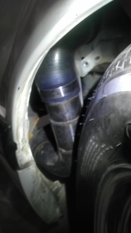

there isnt exactly much space, but that was my old cold pipe.. this is what i have now.

Slo89:
Can you show us how your cold side is ran through the inner fender ( if your fender is off ) and down to your inter-cooler.
Nice to see you fixed that 90* bend....It could have cause all kinds of problems.

it is a bunch of inefficient bends lol... but i will try to get a picture for ya.

I plan on redoing the cold side in aluminum piping soon, and when i do i will eliminate 1 of the 90* bends in the inner fender area.
When i did my piping this way all i had available to me was the existing On3 pipes, which is why i routed them the way i did.
