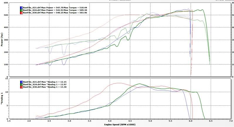

some food for thought... EGTs
for some reason not lot of people run a EGT gauge and there's LOT to learn from having one

Seems to be alot of confusion. A/R size is critical to performance. You want the smallst a/r possible for the level your at. At 500-700 rwhp there is no need for anything over .68-.71 unless you just like to hurt performance bc your not going to loose anything up top at that level on a 4.6-5.0L engine. The larger ar will just waste exhaust energy.
I fell on this bandwagon initialy and got a cast wheel 6765 with a .96 ar (t4/3"vband). And it was a dog on my 4.6L 3v. Switched to a .81 ar housing and peak boost shifted around 100-200rpms to the left. Did my homework and got the same size turbo 6765 with a billet wheel this time and a .68 ar turbine housing. Even at 650rwhp at 16psi which is the max i pushed these turbo the .68 lost no peak power was within a few hp of the others.
Here is shot of some of my pulls testing the 3 different setups I have had.
12psi runs, ebc duty cycle unchanged.
Blue line is cast 67mm with .96 ar
Green line is cast 67mm with .81 ar
Red line is billet 67mm with .68 ar
This is all on a 65mm turbine wheel. You can actually get away even more with smaller ar's the bigger your turbine wheel is with out loosing any flow up top. The .96 at this level would be okay on a smaller turbine wheel ie 60-62. etc
Im switching to an oil-less turbo next and im doing a 7270 (5mm bigger on each wheel) with .68 and going for 700-750rwhp at 20psi.

Being as close as you can to 1:1 makes the power, each combo is diff. Small a/rs do not help this.
I just noticed you guys only go to 6000rpm on a few of those runs, I fig'd those motors went higher. RPM also plays a big role, more rpm a larger a/r would help also. Tune ups basically the same and weather conditions on those runs?
I'm not trying to be biased, I don't know 2v, 3v, or 4v stuff very well haha. Just talking turbo basics. Not everyone want the type of power I want either. I say try the .68, do back to back testing if possible and report back.

Jeez looking at your dyno sheets makes me want to put a .68 a/r on my Turbo. I see no loss of power up top and way more mid range and wayyyy faster spool
Looks like you saw 10 psi @ 3700 rpms with the 68 vs 10 psi at 4500 rpms with the 96.
You could use one of those ebc with the ability to compensate for boost dropping.
You drop to nearly 10 psi by 6k

My car peaked at about 6200 on the dyno...might see 6500 shift points but it doesn't look like he was nosing over at all on his sheets.
Looks like it went to 6400 or so with the. 81 and no signs of falling

Yeah I seen the graph, and never mentioned falling off. Just said he wasnt turning much rpm. Woulda been nice to see all to same rpm also since the graphs overlay.
I thought mod motors turned more rpm also.

Depends. 4v mod.motors do typically turn closer to 7k. 2vs not so much. Even with ported heads Cams and edelbrock manifold looks like my car started to nose over at 6200
Really no point in taking them much higher than 6500 or so...most people probably shift around 6k though
