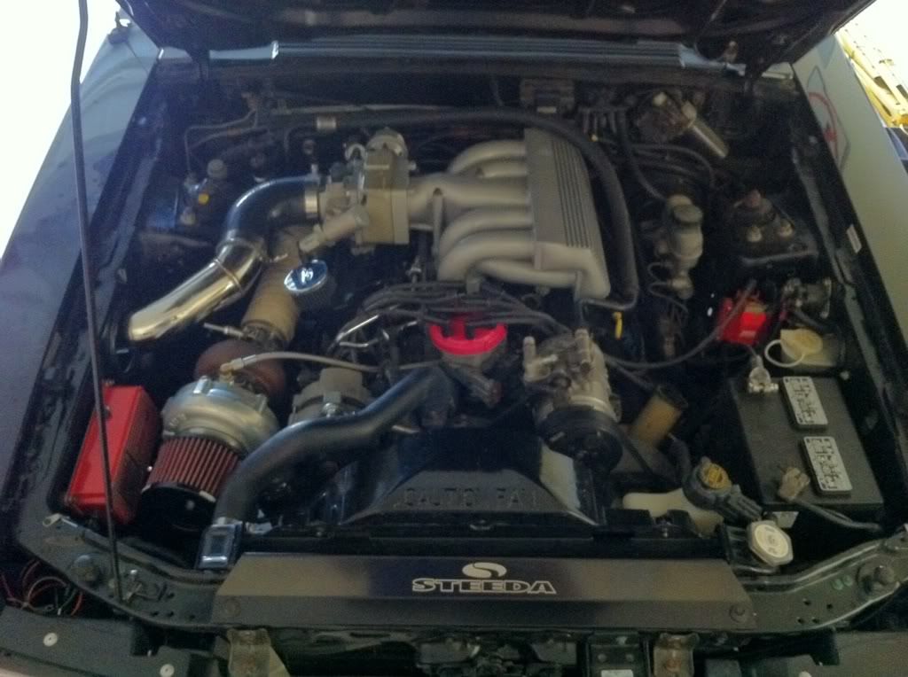

Like the title says I'm headed back to the dyno Saturday w/my turbo combo.
9:1 comp.
Scat rods
Mahle pistons
Anderson b31
GT-40 y302's (ported to a 1262 intake)
GT-40 intake (port matched lower)
LMaf
70mm tb
On3 turbo
255 pump
60lb injectors
SCT chip
Etc...
I'm only planning on running 8-10lbs. I've got a base tune in the chip Right now just to get it going. I've driven it a little and have seen 10+lbs. That bothers me a little. I just installed a turbosmart boost T. What's everybody's thoughts on power?

I would get a turbo blanket or move that MSD box the turbo get really hot...

Yeah the battery's goin to the rear so the msd can go there. I made my tune appt. before I got my battery relocate kit.
