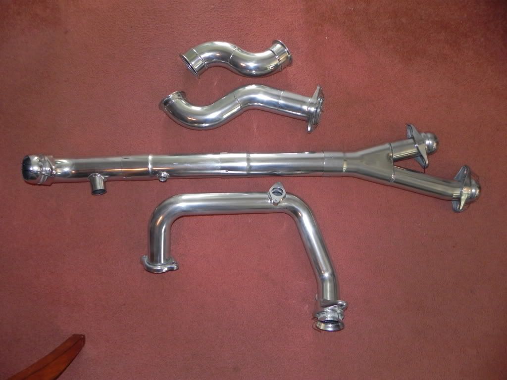

Jet Hot did all of my hot side and cold side. Paid under $700 for everything. Got the polished 1300 coating. I'm very happy with the way everything came out.

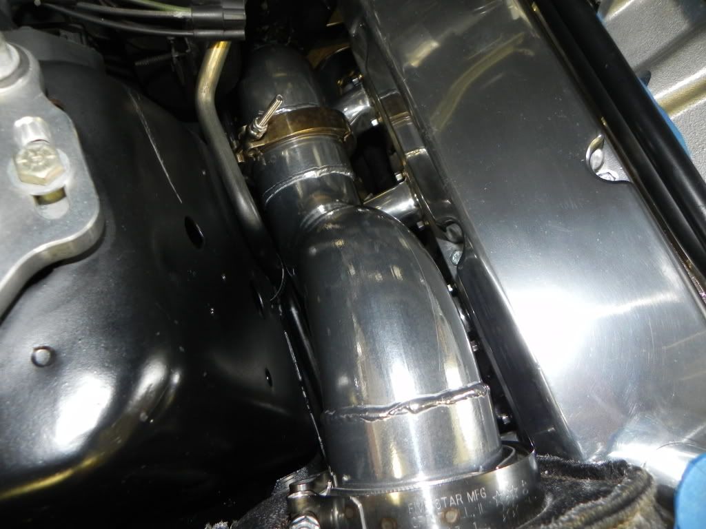

Originally Posted by jturmanator View Post
You got any pics, and did they coat inside of pipe?
They did coat the insides of all the pipes. I asked about durability and they said they have not had any issues with internal coating in a turbo application. Their coatings have evolved over the years, so the durability is probably better than it was in the past.
The shine of the pipes dulls out after a few years, but the coating itself remains strong. My last set of headers were coated by Jet-Hot and after 7 years, the coating was still in great shape.

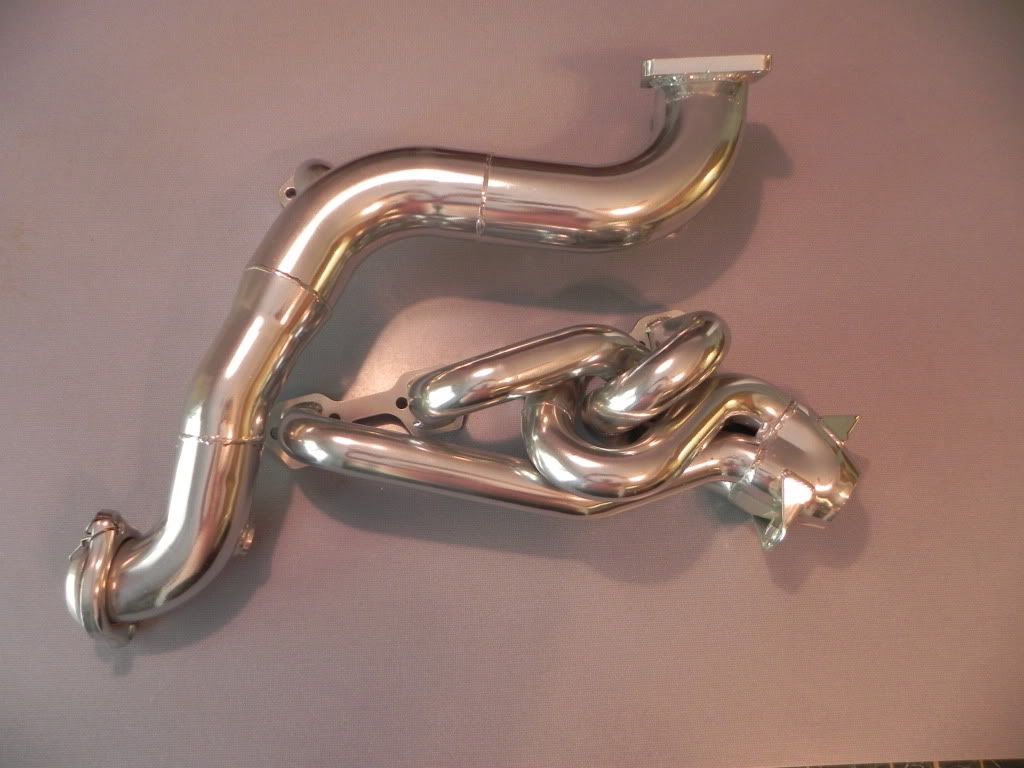

Thumbs up Jet Hot
We are lucky to have Jet Hot about hour away from us, This is all we use for customers that are wanting to get coating done. I had my first gen Hellion kit done recently with the new build.

Thanks, Yes they do inside and out unless other wise requested. We are setup direct with Jet-Hot for in house work, currently we are working on possible dealer options with them but nothing available at the moment.

Chris, is that the extreme 1300? I notice the website recommends the extreme 2200 for turbo Alps and was wonder which would hold up better?
Yes, the 1300 Extreme Coating we have had great luck with it, the 2000 coating came later so we have not tried it yet but sooner or latter it will be requested.
