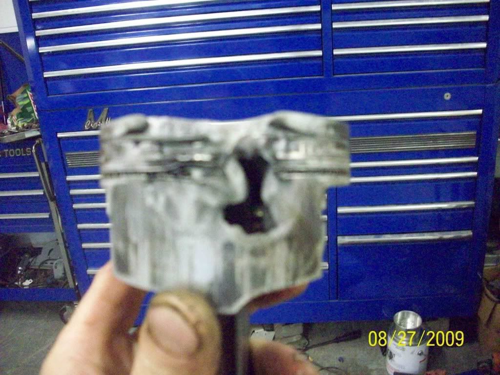

the intake was ####. needed a elbow and cams springs etc etc.. dont get me started..
when it came in, it looked like this, and also a valve seat loose (c heads, go figure)
the cams on this did get degreed when i put it back together. and also went away from the sct3000 draw thru to a slot maf in blow thru. that car was a hot mess when it came to me. 4.10 gears and all...
