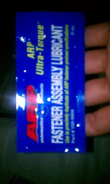

Found this in the box could I use this for the top bolts?

Posts: 49
Yes that is what you are supposed to use. But if you are using bolts and not studs I would not torque them to 95 and 85. Call arp and see what the suggest. I personally wouldn't run the bolts unless they are the pro series which are the same price as the studs. I had arp bolts in mine when the gaskets blew and the arp tech said they didn't have the clamping force I needed for that boost. That's just my 2 cents

I'm using bolts! I've had these laying around for a few months so I might as well use them. So the lub in the box is what I should use for the top and antiseize on the bottom?

Use the lube for the top bolt threads and also on all washers & under all the head bolt flanges to ensure consistent torque. Use permatex thread sealer for the bottom bolt threads.

Just like exploder said. Arp lube on top threads and sealant on the bottom threads. I use Teflon pipe sealant paste myself. Then use the arp lube on both sides of all the washers. You are trying to get a good smooth consistent "wet" torque. I usually go 30, 55, and whatever arp recommends for that particular fastner. You want to make your last pull in one smooth even pull. If you stop just short of the torque, you have to overcome the initial friction to get the fastener turning again. Most likely it will just click but will be wrong. Only fix is to loosen it slighty and pull it again. I just replaced arp head bolts on my engine with studs. Gt40p heads were lifting when sprayed with a 150 shot of nitrous. After studs, I am spraying 225 with no issues. Studs are far superior to bolts in torque accuracy and clamping force.
