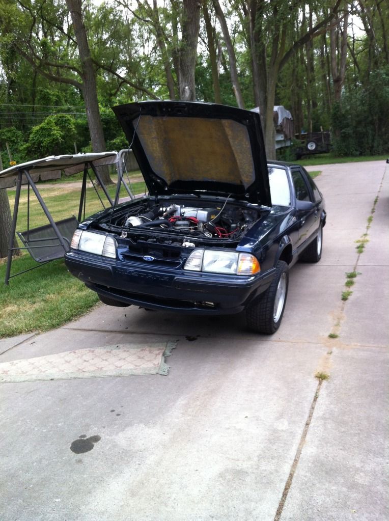

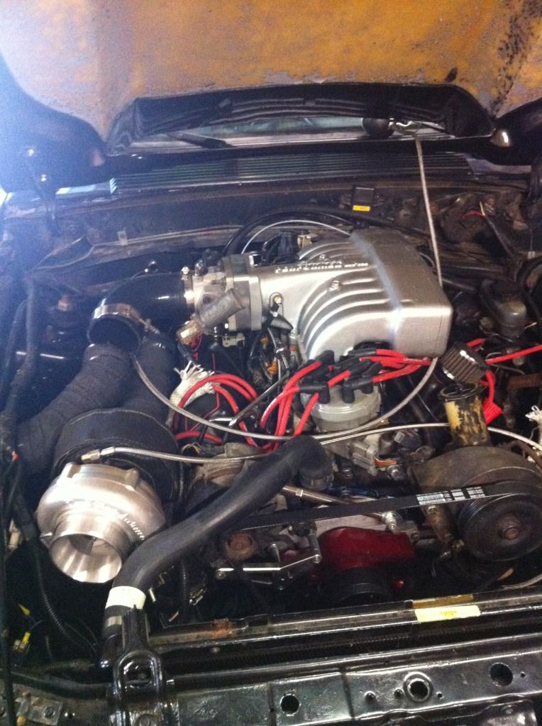

this is how the motor looked
so i towed it home and jacked it up to look around and the bottom crank pulley was hitting the cold side turbo pipe. so i took off the bumper

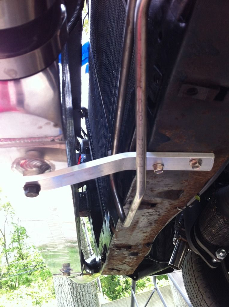

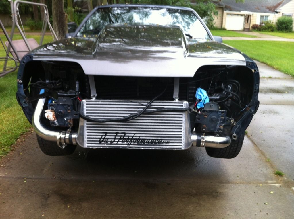

and as you can see in that pic there are no brackets lol the intercooler was held up with zip ties wtf well had to make some brackets and line things up
and here i had to cut a chunk out of the lower inner fender part the pipe was rubbing against metal

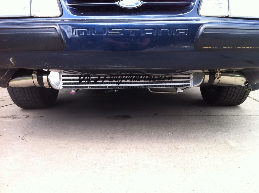

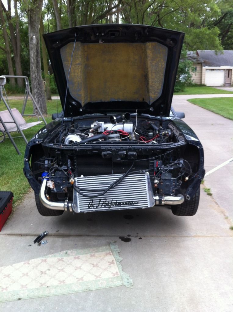

then the bumper would not go on with the intercooler in what i think is the correct spot so out with the jig saw and i cut out a big section out

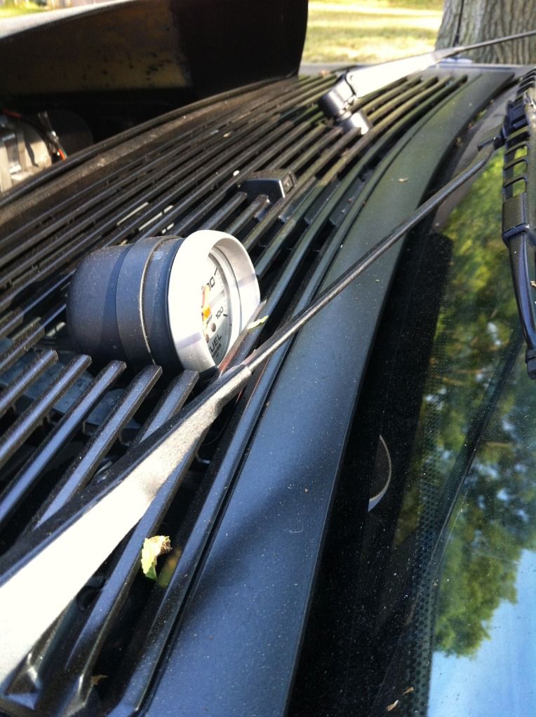

then i had to finish mounting his fuel gague pain in the a$$ but now the hood dont hit it

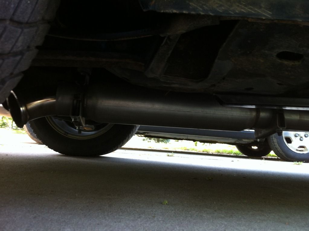

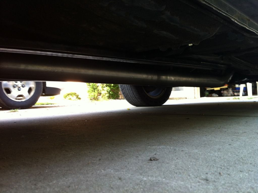

then towed the car in for a 3" exhaust with dump off

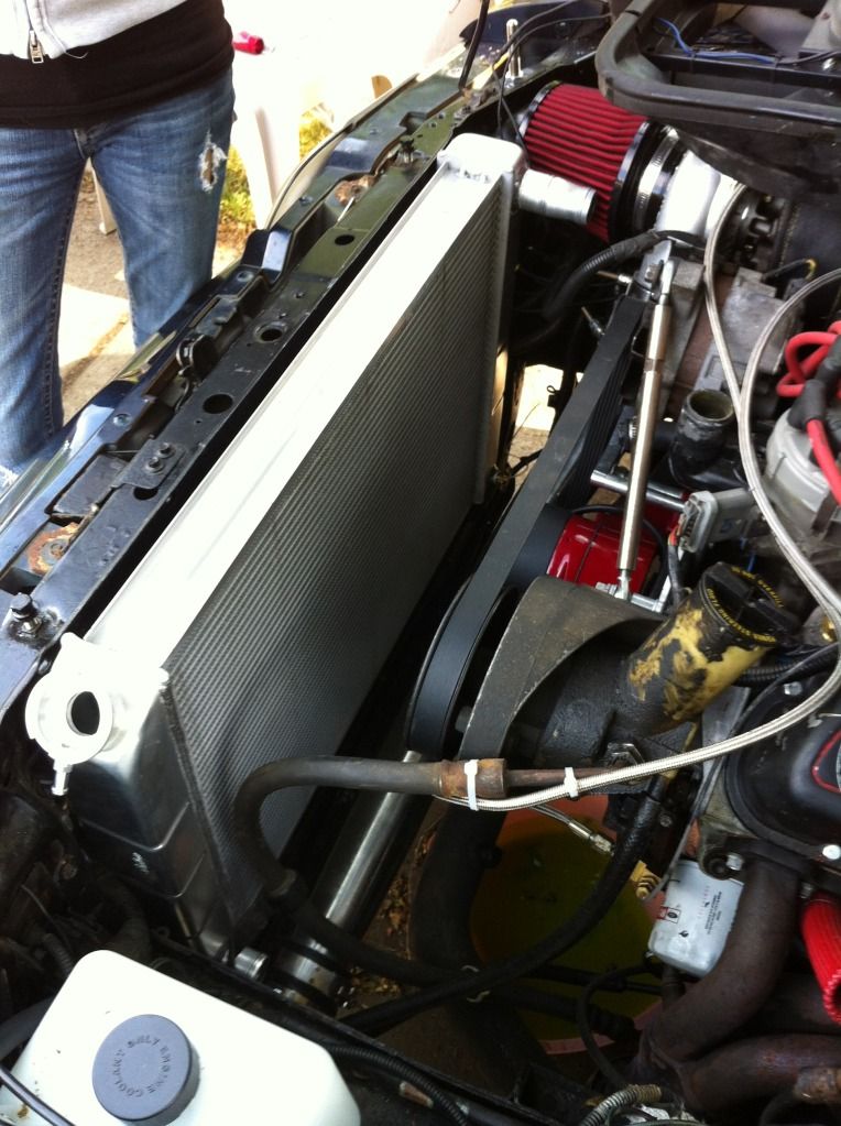

so now the car runs (idles) and it appears all leaks are fixed the day i bought the car 3 weeks ago i scheduled a tune session with lido @ alternative auto and its tommrow wich im glad it took a few because lots of little things poped up! What do you think my rwhp num will be? and would you have taken a 6k gamble on this?

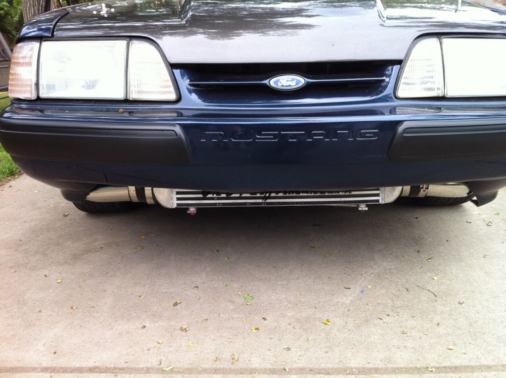

and todays pic touch up paint on the front bumper

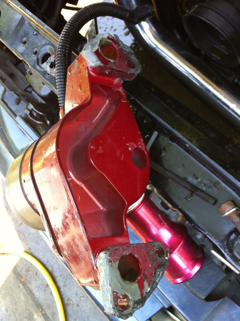

So i got my fan problem fixed was a bad relay wich was also shutting off my water pump.. also fixed a small water pump leak. Got to take out on a 5 mile around the block cruze feels very nice. I gave it full throttle from low 2nd and once it boosts up it just spins. So after i pulled up i noticed some smoke and pop the hood and my turbo blanket or around it is smoking this is pretty much the farthest i drove it since the install but not necessarily the hottest the car has gotten. Is this normal for a new blanket/pipes?
