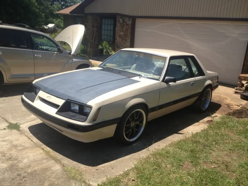

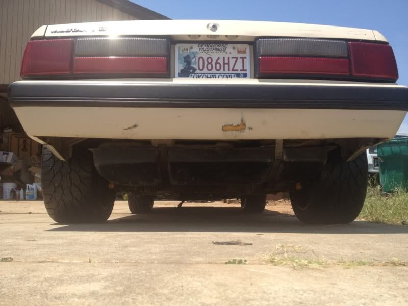

I have a 86 coupe that's been converted with a 88TC motor. Only upgrade so far to the driveline is , 3.27 gears, centerforce dual friction clutch, and Stinger 3"DP to 3" in/out hooker aero chamber. About to thow a bigger fuel pump and manual boost controller so I can turn the boost back up. No BCS limits me to 8lb at the moment.
Other mods include:
Hallman boost controller
MM solid rack bushings
MM steering shaft
MM bump steer kit
MM cc plates
Koni shocks
FRPP C springs
Steeda x2 balljoints
95 spindles
95 GT 8.8 converted to fox length
Yukon 5 lug axles
North racecar rear brackets
03 cobra front brakes
95 Lincoln towncar 1" bore master cylinder
Wilwood perportioning valve
MGW shifter
Aftermarket 2 core 100% aluminum rad
18 x 9/10 94-04 offset wheels
234/45 & 295/35 KDW II
