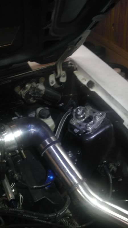

post #8 of 10 Old 06-01-2012, 06:46 PM
Location: Hurst, Texas
Posts: 3,565
Old.
New.
Moved.
I put them on a plate that is setting on studs so it can be pulled easy enough if I need to.
I was getting too much oil vapor fume for my liking. Mounted in the rear and problem solved.
kbscobravert is offline

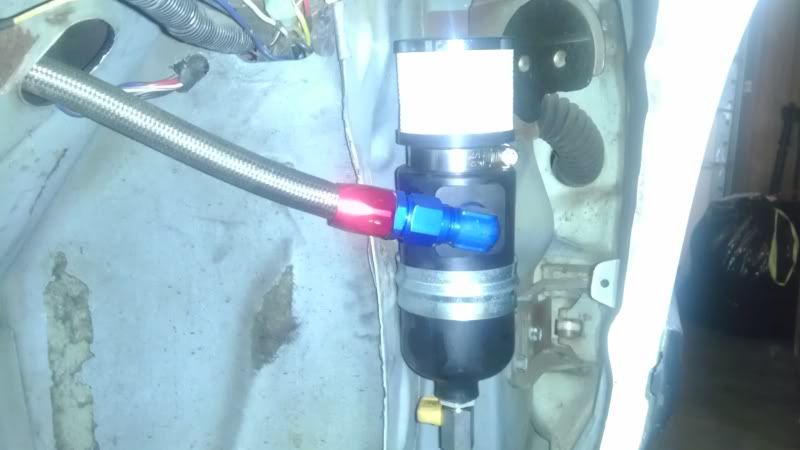

post #10 of 10 Old 06-01-2012, 11:02 PM
nasty92lx's Avatar
Join Date: Mar 2011
Posts: 448
ps I still run my battery in the bay too and I just mounted my breather tank to the drivers strut tower. It works very well for me. I don't think it looks as nice as dude with the black vert but my setup cost me $100 bucks for the fittings lines and tank with the filter and getting all the bungs welded. I will make a nicer looking car someday until then, it's function before fashion. btw that dude's build is insanely nice I strive to make something look that good and run like that someday!
