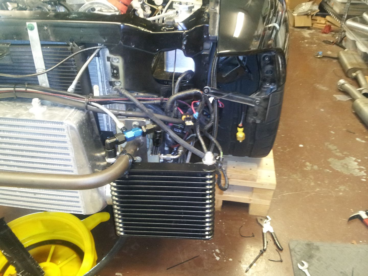

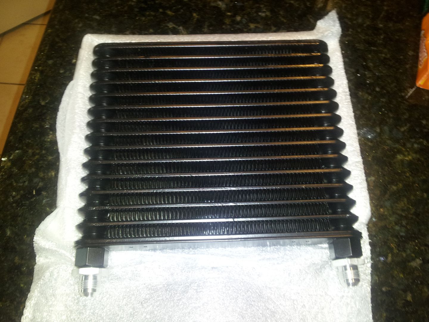

I am moving my remote oil filter and installing a oil cooler today. Here is the cooler I am using.
Derale Cooling Products 15851 - Derale Performance Plate and Fin Engine Oil Coolers - Overview - SummitRacing.com
Disregard the zipties. I am checking to see if it clears the bumper cover.
The fog light opening in the Cobra bumper cover is empty and the cooler sits right agains the covers opening allowing a direct shot of air onto it.
I would like to put a temp gauge on it. Next week I am doing the last lef of the Hot Rod Power Tour; up to Oklahoma 280mi and back another 300mi.
