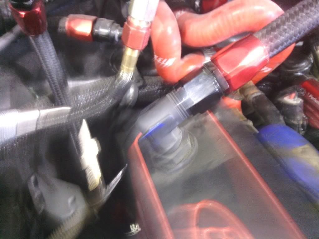

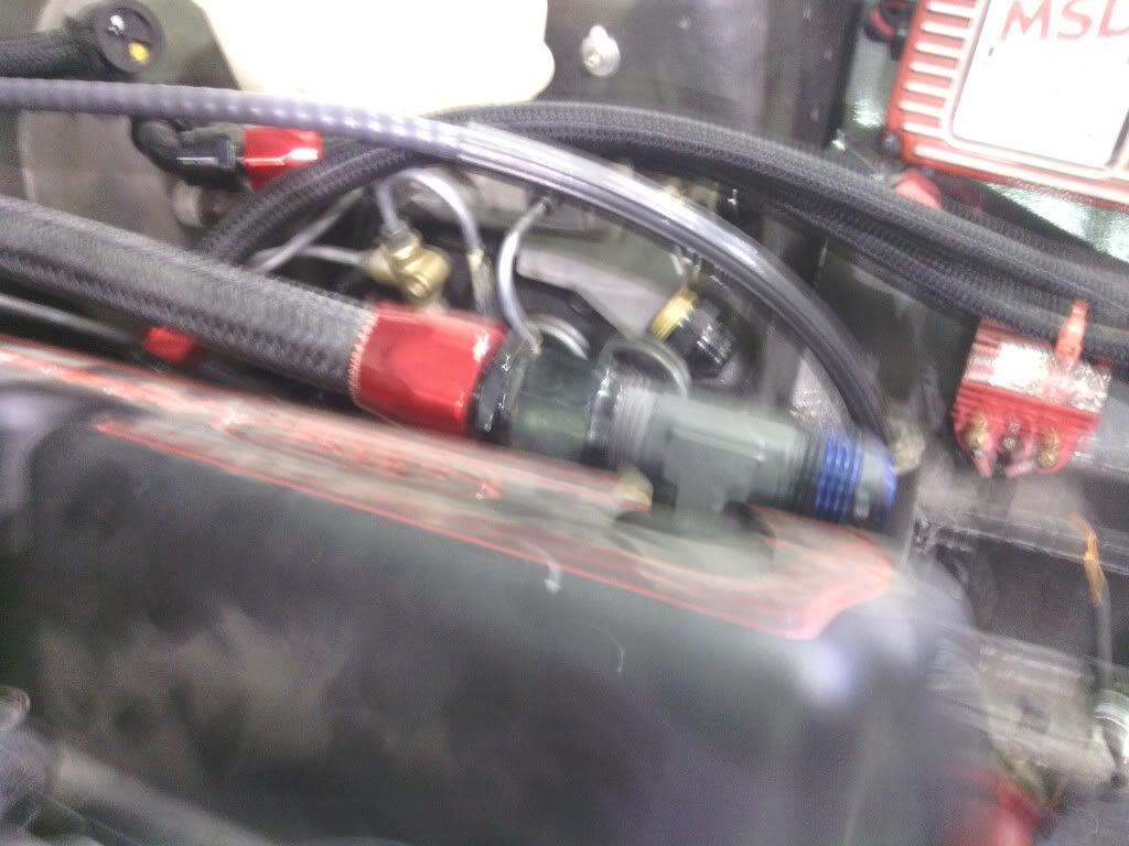

I haven't ran my new setup yet (and won't be for a while) but here is mine in it's mock-up stages:
-Scott

I done similar to raceaholic except not near as clean. I used 2 passenger valve covers and welded a -10 bung on the vent tube and put a bulkhead bung in the pcv hole and did not use a pcv valve.

Originally Posted by raceoholic330 View Post
I haven't ran my new setup yet (and won't be for a while) but here is mine in it's mock-up stages:[/IMG]
This is what I'm talking about....Great Pics
What are the part # for the items you use?
and how did you do your valve covers?

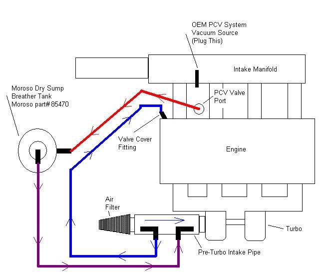

heres what i do with alot of the street cars
new filter, rubber and a turbo coupe pcv valve
put some extra hose on it
plumb one of these in it
and have it drawn on from the intake stream
valve cover i plumbed on this one im still testing. but it works well.
hosed them together and ran them to a closed catch can
the hose going into the fender is plumbed into the turbo inlet side(sorry for the ####ty pic)
seems to be working rather well.

A vacuum pump is a great thing if you can get the setup to fit and work reliability. For a race car, you're right, a vacuum pump is a must IMO. Most race engines have low tension piston ring packs, so the negative pressure in the crankcase is a must. There is typically a 30-40hp gain to be had compared to not using a vacuum pump on a racing setup. The negative pressure in the crankcase reduces piston pressure on the downward stroke allowing the engine to spin easier.
The main benefit from utilizing a pump on a street car is that it keeps the oil cleaner and reduces blow-by in addition to sealing the rings better, so a 15-20hp gain is relatively common. The issue is that most evac setups are built for racing, and reliability can become an issue. People have tried to adapt air pumps to be used as evac pumps, but the oil going through the pump seems to kill them after a couple thousand miles.
The catch can system is a push-pull system depending on whether or not the car is in boost or not. It is not the cleanest system, but it does work and has been proven to be a good solution to eliminating crankcase pressure on boosted applications. Frequent oil changes are definitely necessary. Somebody needs to create a reliable, compact, and affordable street car evac system. They will make a killing.

for those who have or are running dual catch cans....one for each valve cover.....do you guys have any pics.
TO: Gearhead559
It looks like your running 2 different types of catch cans on the same car.....I can't tell....Are you?
one looks like a normal billet style can, which is cap off on on end, and the other is the clear type near the back of the engine "OR AM I LOOKING AT THIS WRONG"
The clear can looks like a design 2002mustanggt has or did.

yes, the billet catch can is drawn on by the inlet of the turbo. so its always getting suction. same goes for the pcv valve(i just have the separator there to keep oil out of the intake stream) but not under boost! hence why i used the turbo coupe pcv valve

2 ways of doing it
pick your poison
