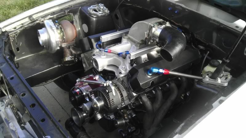

This is a 351W bored .060 with, 26cc dish Mahle pistons, 6.125 rods, 3.5" forged eagle crank, and the block was decked to 9.475".
The heads are KPI TFS HPs that have been ported by bennet racing to 227cc and out fitted with del-west 2.05 titanium intake valves and manley 1.60 stainless exhaust valves. T&D shaft rockers and beehive springs.
The cam is a 2nd hand Ed Curtis HYD roller
The turbo setup is a cut up On3 kit.
And here are the pictures.
In this pic everything is loose so i can figure out how i want to run my alternator.
Thats as far as i have gotten for now. Tomorrow i hope to have most of the piping done, and the fuel lines hooked up.
Thanks for looking.

how close is that intake set up to the hood? I am wanting to ditch my 4 inch cowl, but my box intake makes it need to be that tall,

Thanks guys, i got some new pics i will post up tonight. The Turbo is the 76mm from on3, after i get my tax return i plan on going with something like a S375. BUT i am open to suggestions, so any input is welcome.
It hits, i would probably need a 2.5" cowl for it to clear, which will have to wait till tax return time

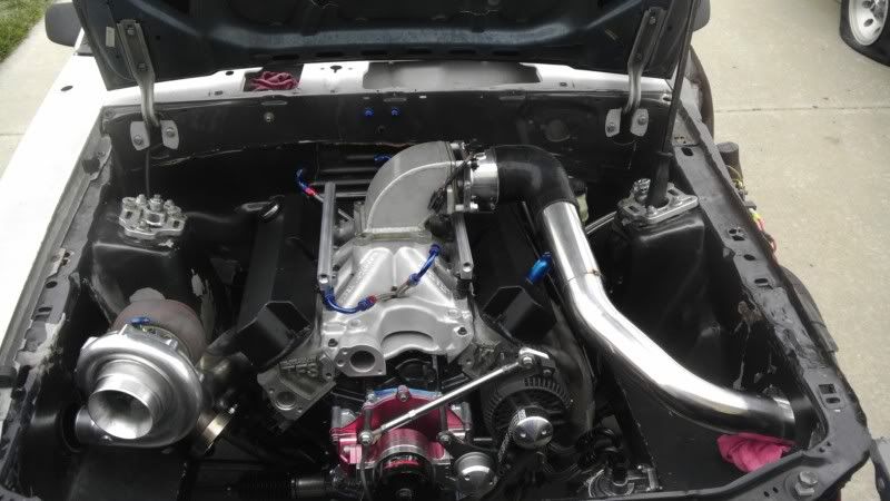

I was able to make the charge pipe today, now i need to make a 1/2" throttle body spacer, and extend the down pipe ~4"
I probably wont be able to get any work done on this till friday, but we will see.

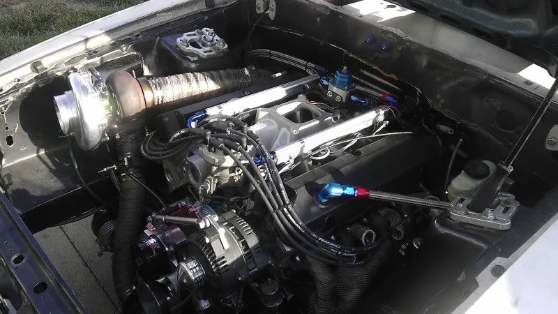

ok, i made more progress. The fuel lines are done, the regulator is mounted, transmission is in, down pipe is has been extended and re-wrapped... im sure i am missing some stuff but here are the pictures.
Today i hope to get most of it buttoned up, and MAYBE (weather permitting) try and fire it up.
Oh btw if anybody wondered why i have a mixture of Blue/Red fittings and some Black fittings, all the Blue/Red fittings are old and the Black ones are new. Eventually i want all black fittings.

302, and because of that the turbo sits to high... then again i am running High Ports, so those may play a roll in the turbo sitting to high, oh well.
Also i had to extend the down pipe ~2"
And this is the progress i made today.

nice! what size evac u running? just 1? Is oil fill bolt in or welded? what size is it?
What about the crossover? I take that it needs to be extended.
Is the downpipe the one that came with the on3 kit? I was worried about the room by the shock tower.
One more question. Do you have stock height mounts or the lower convertible style.
Sorry for all the questions, just trying to see what I am in for.
Definitely got me motivated. Keep up the good work!
12an,l and yes just 1. I should have welded a bung into the other valve cover too. The oil fill cap is push in. I want a weld on or bolt in one, so if you have a link to one please post it.
