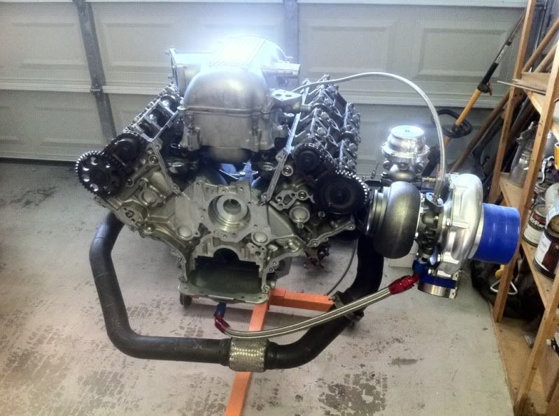

76mm Dohc turbo!

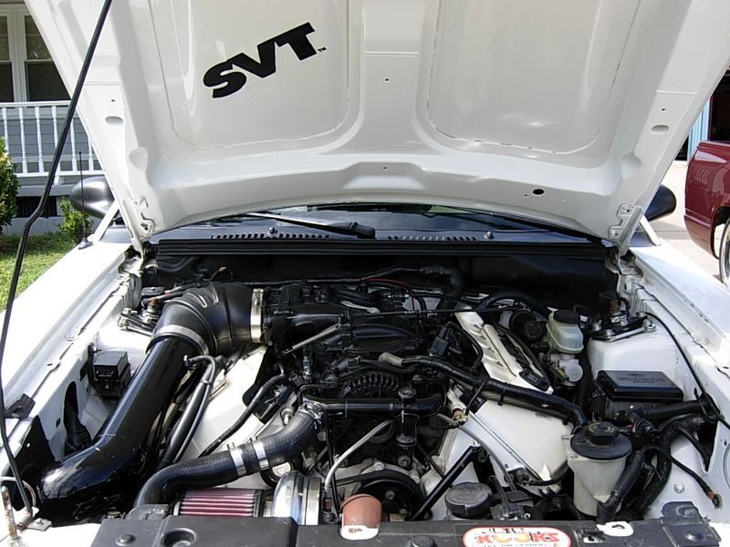

How should I run a mass air meter in my setup http://www.DeltaForceTuning.com/Prod...0&Show=ExtInfo I'm thinking about the bazooka from sniper. I was told I should run a BA5000 but I get mixed input on that. It was sold to me as a PTK kit? I don't know how they were planing on running one on this setup unless it was in draw through and the blow off was recirculated some how. I bought the piping used and he didn't have much info on the kit. The down pipe is odd too. Im going to cut it and do the whole exhaust once I bolt it up next time for a mock up. But I'm looking for a fue good ideas on the cold side. And do you think I should step up the down pipe from 3inch to 3 1/2 inch? The round opening just past the intercooler is for a 56 mm blowoff valve.
The car will see 15-18lbs of boost and is a street car. I use delta force comando softwear for tuning.
Thanks, Robert

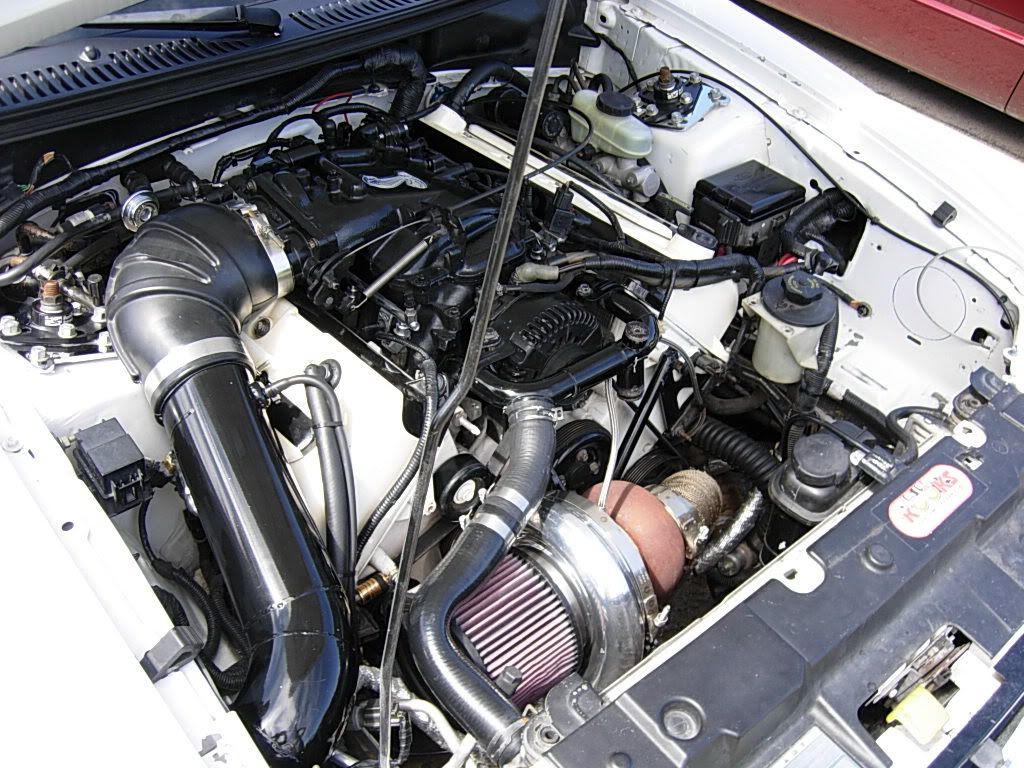

I might be able to run the turbo like this if it would help the down pipe or inlet setup. Although I don't think it will look as good in the engine bay.

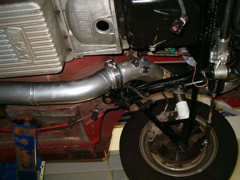

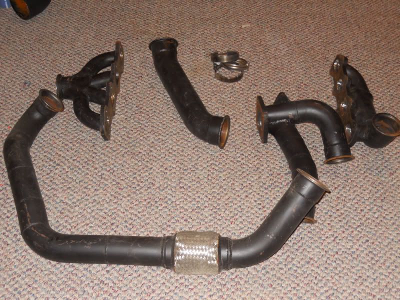

I was thinking of doing something like this for the exhust. This is a custom one a guy built that looked good so I saved some of his pics to help finish mine up. he went with 4inch

Blow thru is my recommendation for sure , and a slot style meter is a little more forgiving with the tuning on boosted car , but either should get the job done , SCT BA5000 slot style would be my suggestion
I once read that posisioning of the slot style meter and what the piping was doing before and after the meter, was a factor as well.
How's the ba5000 going to do on the street at normal driving conditions?
Can you get the weld on flange for the slot meter? Or have a link to one?
Robert

Originally Posted by Robs4valve View Post
I hope youre not planning on running that pcv (or w/e its considered on that particular engine) on that intake tube....
Willie would you put the meter in the straight section just above wear the bov is now? And if so should I move the bov? And if not wear is the best place for the meter?
Robert

you want it away from the BOV , closer to the TB if possible , but in a straight pipe before and after the meter and same diameter pipe for as long as you can fit it , its all about LINEAR AIRFLOW , as long as you do calculations and set the meter up to use up to 80 percent of its capable airflow in whatever size pipe you choose then you will be fine at part throttle , basically if you set it up so its only reading 3 volts or less at WOT , its gonna run like crap on lower RPMs and idle
In-between the last 90 and before it goes into the polished aluminum section sounds completley out? It reduces down. I've kinda wanted to redo the cold side anyway. Now it looks like I have to. Any idea how it was intended to run?

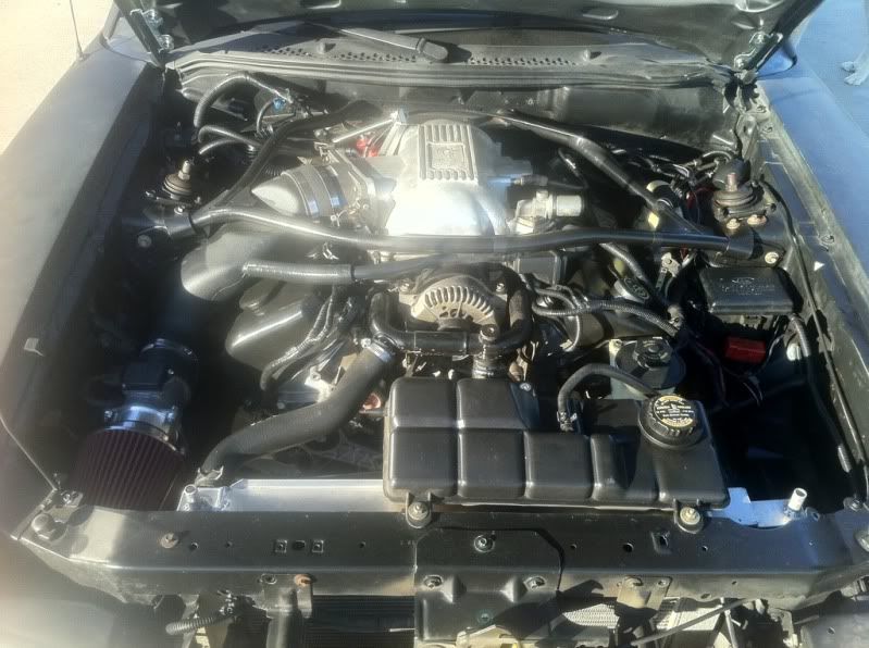

i put my mass air in the pipe inside the inner fender on the pass side where it has a decent length of straightness on both sides once the maf was installed. i may have pics of my turbo build somewhere if interested. it was a 4v as well..

Sure, post them,or a link is cool. I thought I have seen ppl run the iac hose into a cold side before? Docent that air need to be metered also?

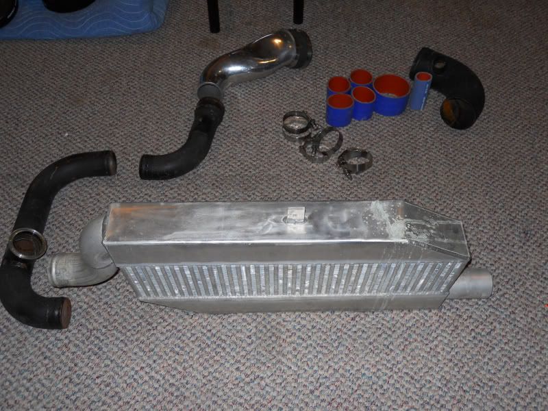

Oops sorry ...its been awhile since i turbod that car... the meter was in the intake tube in the engine bay about halfway up it. I remember that because that is what the meter was calibrated for (3.5" pipe)
It was a weld in mount for the MAF. i put it on the underside of the pipe in an attempt to make the engine bay cleaner. It was only a lightning 90mm maf if my memory is working right haha
The line you see close to the throttle body on my cold side was my wastegate line. I tapped into the egr delete plate for my boost gauge

Look to the left side of the intake you can see some of the welds where the MAF mount is

How'd it spool with a 3.5? It looks like my old JLT cai!

the 3.5" was ONLY the part you seen there, the rest was 3". It "was" an anderson power pipe but its all i had at the time so i made it work with everything. It spooled very quick, specially for the size of the turbo.

Any thought on the down pipe? I think 3" is to small.

i had planned on running a 4" DP thru the fender and out the fender right by the driver door. I ran 3" for the longest time and it didnt seem to hurt anything, but at your power levels i would run atleast 3.5"
You can see the circle i marked in the engine bay where i was going to cut for the pipe in the second pic haha

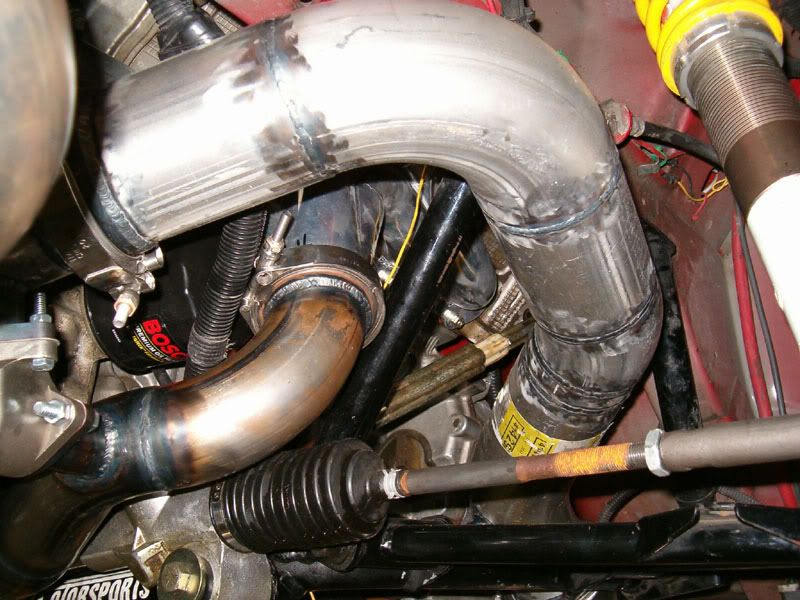

How would this work?
If I cut and rotate the joint that says "cut" 45 degrees counter clock wise and get rid of the 90 before the pollished section and make a 45 at the transition. So their is a straight run and put the slot flange in that new straight run.
Any one ever seen this kit before? I can't find one like it any wear. I'm thinking it might be coustom. the seller tried selling it for years on different forums he started out asking 3k for just the piping and intercooler, he said it was ptk every time.

I don't see how that down pipe will work with that turbo that far towards the driver's side. I just got done with my turbo set-up on my 4v and trust me space is tight unless your putting this in something else.
Yea it's going in my 96! I've had it bolted up. I relocated the battery and it fits fine. The New down pipe will go through the fender and around the suspension/kmember. The only issue was the meter location. I've known I was going to have to fab up the whole exhaust.
Any more input on the location of the BA5000?
Robert
i would leave that where it is. Personally i would weld it to the chromed piece(basically one-piece in engine bay) and then weld in the maf mount on the underside about in the middle(maybe further up towards tb 1/2-3/4 way) of the straight part of the piping.
The pollished aluminum part? It is about the most un uniform part of the whole cold side. I think it needs to be in a true round pipe for as straight as it can be.

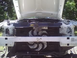

i cant say anything about intercoolers because i never did any comparisons but i ran one with the tanks on the end. Also i didnt notice any differences when i capped that hose off from the coolant crossover to the t-stat housing. I used a rubber expansion plug but if i had to do it again i would just weld it shut. I had to trim the rubber off of the plug for the bottom blockoff as there wasnt a size that fit it perfectly....
As far as how good the the Intercooler worked... I put my hand on the turbo side of the I/C after a hard run and about burnt my hand , the other side of it was ICE COLD !!
Sorry..i like posting pics as a reference lol i know it helped me alot on my build!
I had to cut into the actual bumper to make the I/C fit

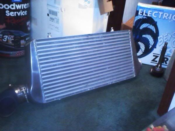

Thanks, I am looking at a ic that ia 31x12x4 with 3" in/outlets. I never liked the cold side of this kit (love the polished aluminum part).
So I have made up my mind on finishing up.
1) I'm going to go with 3.5" down pipe back to a Y then dual 3" back.
2) replace all but the aluminum part of the cold side with 3inch aluminum piping and a new 31x12x4 IC. (like 89cammingt's style)
3) Ba5000 in the middle of at least a 12" straight section of 3" piping.
That should do it! Thanks guys.

My car as of now,
96 Mustang, 98 Teksid, Manly 11cc pistons, Manly H beam rods, 98v forged crank, ARP throughout, 01 C heads with a little exhaust porting, 98 cobra cams, 76mm PTK/custom turbo kit, ams boost controler, Snow stage 3 methanol injection, Rebuilt 4R75w controlled with a Quick1, Lentech valve body with transbrake, 3600 stall, bronze Volk TE-37 wheels and Micket Thompson's all the way around. Burns gas and rubber! Delta Force Tuned using Commando.
When I first did a turbo on my car I ran a MP T70 .96 ar wit a 3'' Dp. Car went 9.33 @145 on 17psi. I couldnt get the turbo to make anymore boost.
Very nice! I'm kinda seeing a lot of good results with 3" dp's. I've been reading and thinking all day.
Do you think I should run the 3.5? I have to build it anyway.

I ran a 3.5'' on my Gts78 I had. Worked fine.Went 8.87 @ 154 with that turbo. If you have to make it then do the 3.5
