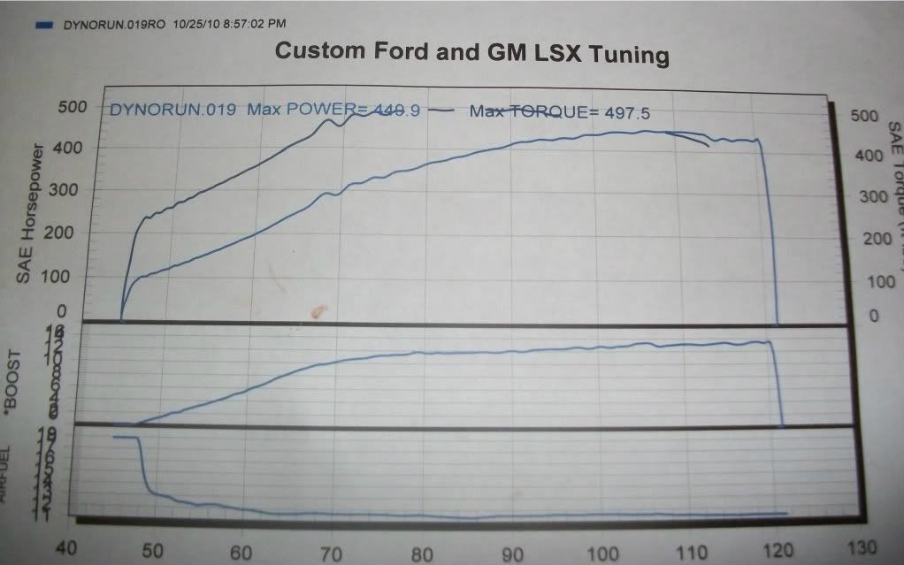

another local 5.0 just made this
just at 13 lbs on pump and stock heads with mls and studs with an f cam and a cobra intake the car made 424/511 to the tires.
and this one is a few years old that i know of
On 10lbs it made 430&500, with stock everything, minus a professional products intake and 70mm tbody.
