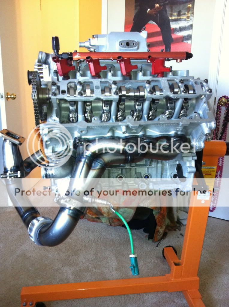

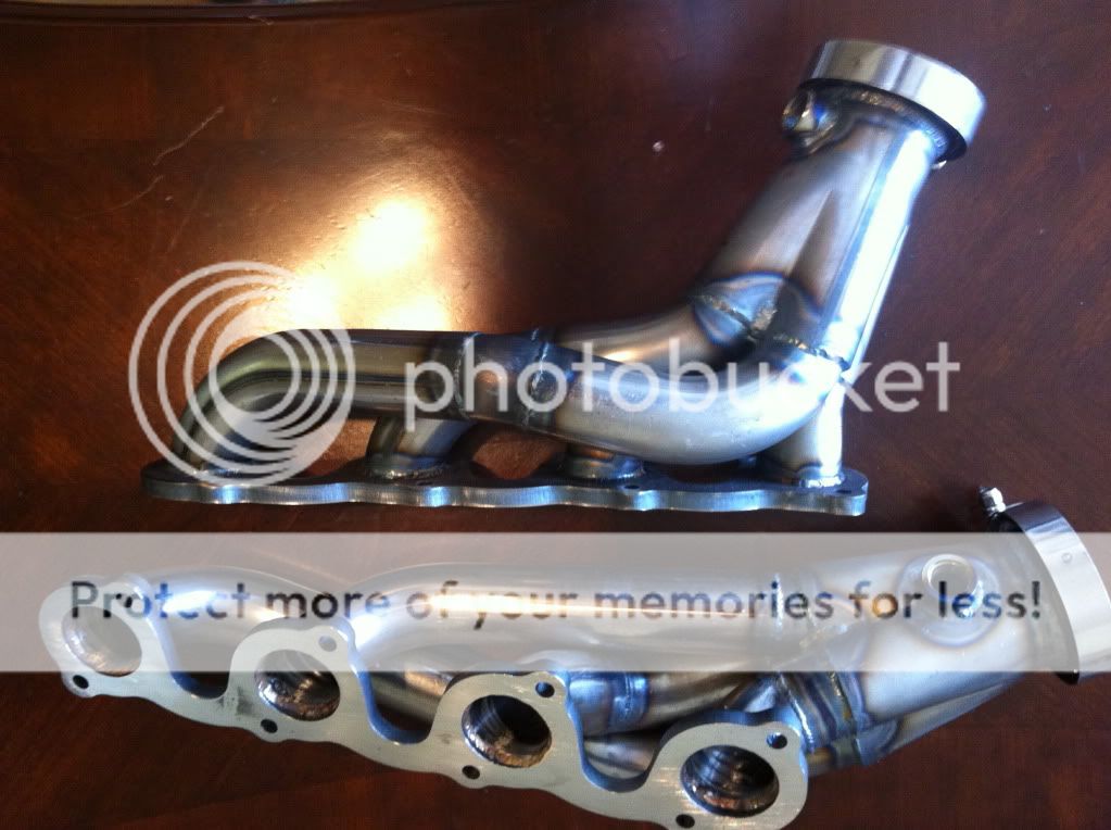

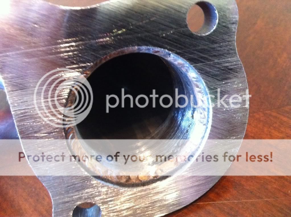

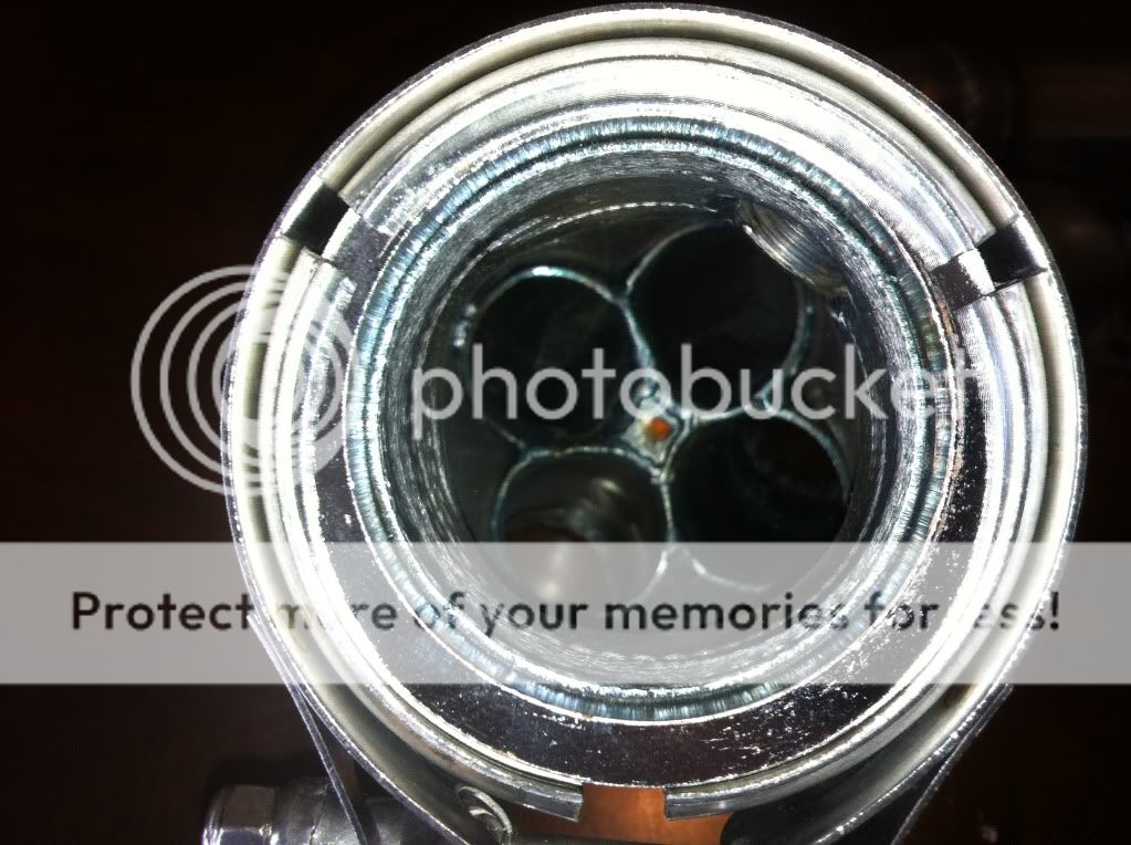

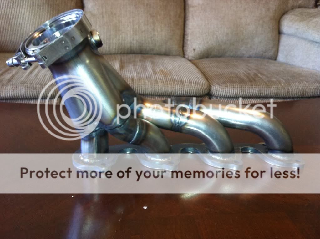

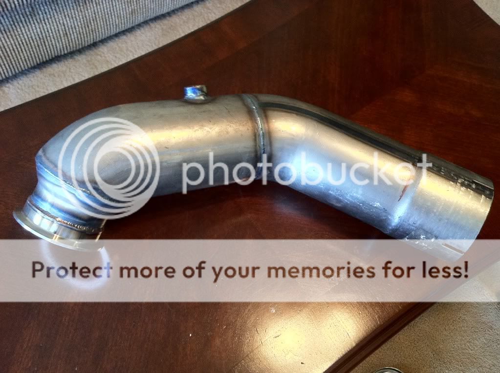

I just got my CG Fabrications hotside from Caleb. He is a great guy and the work is awesome! I ordered my kit with an upgraded 4" downpipe. Im so excited...

Looks like good quality stuff, I'm impressed.
And their prices seem reasonable.

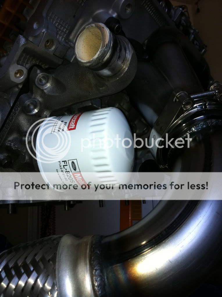

Nice!! Can you use oil filter or have to use relocation. The one thing I didn't care for with my new on3 kit is oil filter relocation, I don't trust oil filter relocate.

The base kit is $1150. He only charged me $40 extra for the upgraded downpipe. Shipping and handling was $65 so the total bill was $1255. Totally worth it imo

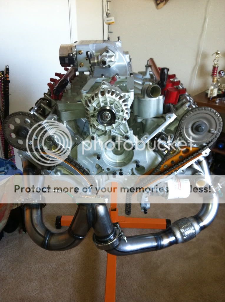

Ok I just bolted it up to the motor and this kit will NOT work with a/c at all. It wont even work with the a/c delete pulley. Not a problem for me though
Was it suppose to?

No he told me that it was not going to work with a/c. I just didnt expect that it wouldnt work with the a/c delete pulley either. I was sort of hoping that I could possibly install the compressor and modify the lines to fit, but thats ok that I wont be able to. The description does say that its a "race kit" so I guess I should have expected this

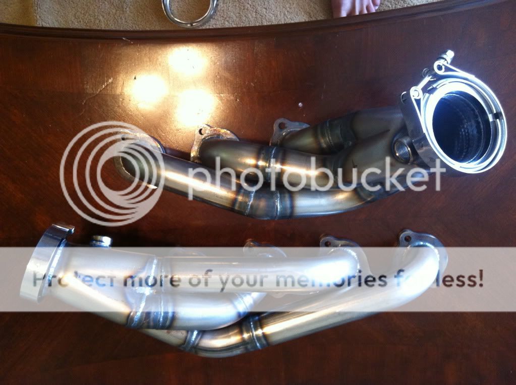

Its 16 gauge mild steel. The headers have 1 5/8" primaries and the crossover tube is 2 1/2". Header flanges are 3/8" and the turbo flange is 1/2". Ill have pics of it mounted on the motor here soon. I asked him about building me a coldside and he said he didnt have a car there at the shop to get it done right now. Hes going to build me an intercooler for it though. The prices are very reasonable for the quality of work that is done

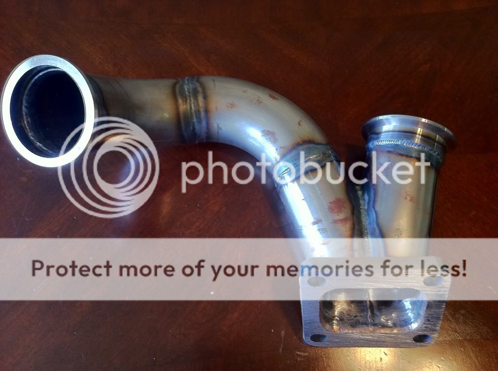

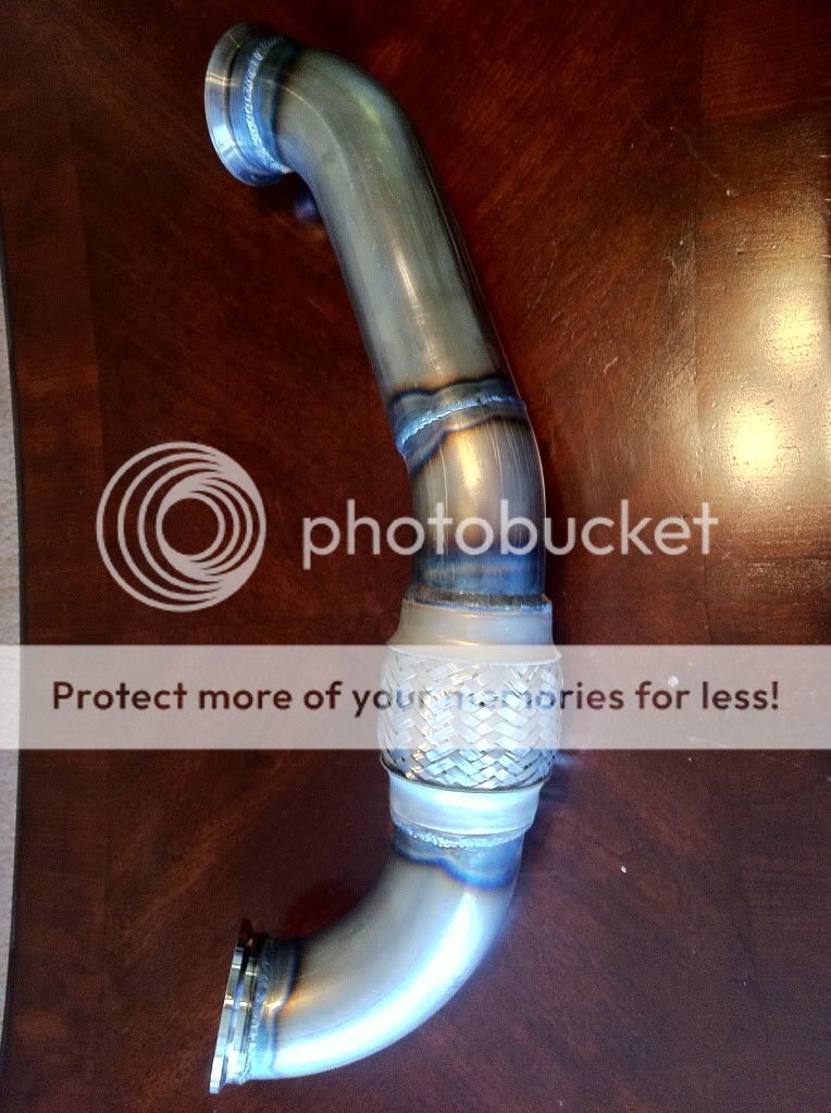

[IMG][/IMG]
[IMG][/IMG]
[IMG][/IMG]

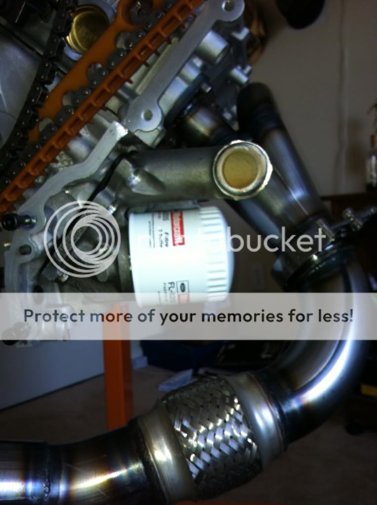

Oil filter clearance pics for 2002MustangGT......no oil filter relocation needed
[IMG][/IMG]
[IMG][/IMG]

In the bedroom with Scarface...nice

Thanks and yes it is scarface. If you look closely there's a 3/4 empty bottle of hennessey too lol
You beat me to it.
Engine in the bedroom. My other half would have my head mounted on the wall if i pulled something like that.
Those are nice and clean welds. Going to have him make my next setup.

Thanks for the pictures!! wish my kit could use stock filter location but yes I have ac . Vegas is too damn hot not to have ac

why didnt they add the WG flange??? other than that it looks baddass

well i wouldnt have liked it as much if they put a wastegate flange on it. then i would be limited as to what kind of wastegate setup I want to run. its probably going to end up getting dual gates and put one on each of the crossover tubes
