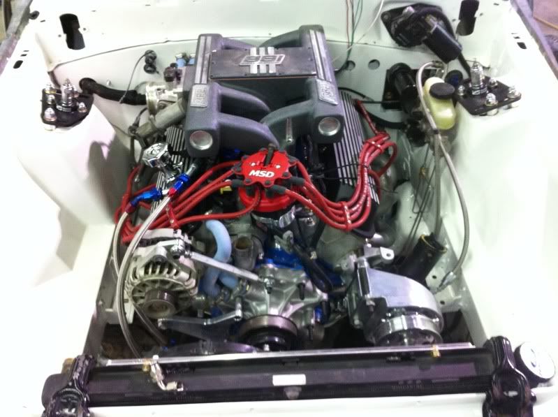

hey dudes, whats up?! im fixin to get started on my remote mounted turbo system on a foxbody.. im not lookin for the kinda advice where people are just gonna down my idea, im gonna do it regardless of what the nay-sayers will say.. i have a turbonetics ball bearing 62 mm, shes beautiful... lol anyway i am planning on coming out of my off road h pipe with a y pipe to 3 inch stainless to go into the turbo, all with v-band stuff and 3 inch out and "y" into my flowmaster 3 inch muffler back tailpipes, my turbo will hang where one of my mufflers are from the factory, either passenger or driver, havent gotten that far yet.. im building a remote oil system just for the turbo. should i intercool it or just go straight into the throttle body and run water/meth?my turbo compressor outlet is 2.5", could i run 2.5 from the turbo to the IC or TB(depending on whether or not i use a intercooler) then transition to 3 when i get to the IC or TB, or transition to 3 inch at the turbo and run 3 from turbo to IC or TB. im sorta new to the turbo game, besides our 85 SVO, expecially a whole custom build by myself and some of my welder buddies.. also i need my MAF b4 the air is compressed right? any other ideas yall guys have would be greatly appriciated! my motor is all new balanced all forged, studded heads, o-ringed, tfs fox lake stage 2 cnc'd intake exhaust and chambers, bbk ssi upper and lower with a 75mm TB, i was thinkin about goin to a 85 or so TB? i have no idea on what kind of plugs to run either, ill be running 10-18 psi depending on what kinda mood im in.. ;-) im probably still missing something i havent typed im sure! thanks in advance for your input!

I like the hydroboost! very nice

your engine bay is sexy

thanks! took lots of work and time but shes all worth it. all she needs now is my turbo and itll b sexier! ha
