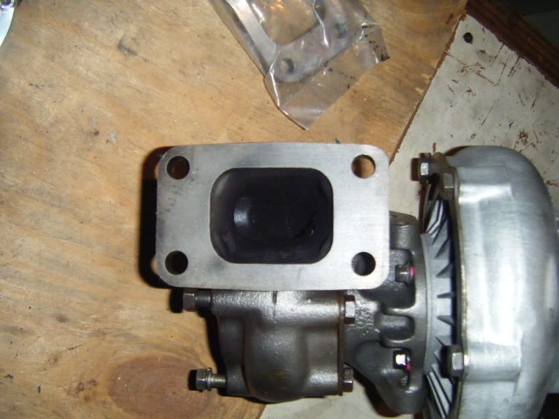

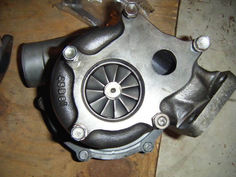

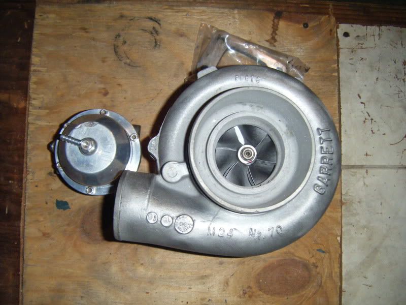

Is this too small for a 306? Its Attic trim...
I have to take it apart and measure it. But if it will make some power ill chuck it on. :nice:
Im not looking for a perfect set up just could use a few more horses.

Definitely a T3 hot side...no telling what the A/R is. Probably small judging by the appearance (which is not always 'accurate'
Cold side looks like a T04E, which might barely be enough for a very mild 302. Get some measurements of the compressor wheel. Probably somewhere in the 57 trim neighborhood if I had to guess by looking.
#6 ·
what'd that come off of a subaru? and where's the turbine flapper cause it looks to me like an internally wastegated turbo. is it some kinda hybrid t3\t4?
