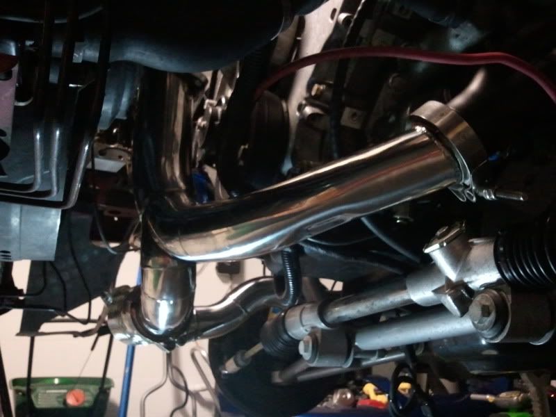

The kit......... This kit, when in your hand is very nice looking. I am a VERY picky person, as the On3 gang can probably agree.... There are a few small things I see with this kit, which I feel I could probably upgrade, or "touch" up....but I don't really want to. I want to put the kit on, as it comes....and see what type of gains I get both on the dyno, the track...and the street.
I will be honest, I was very impressed initially.....by the quality of the components....but I know "time will tell" the truth. I am pretty confident I will not have any negative issues with this kit. I did NOT buy this kit to daily drive, nor to put 20,000+ miles on. I bought this kit to put on a car that sees 2,000 miles every 2 years, and stays in my garage 365 nights of the year.
If this kit performs to my expectations, I will be very pleased. And do not think for ONE MINUTE, that is there are small issues/hang ups along the way that I will complain.....as I realize I saved thousands by going this route. If I need to make a cut here, a weld there....or even re-do all the connections....I honestly do not care.
The kit came just about exactly as pictured:
Some Hardware
Gettin her ready
Tearin her apart

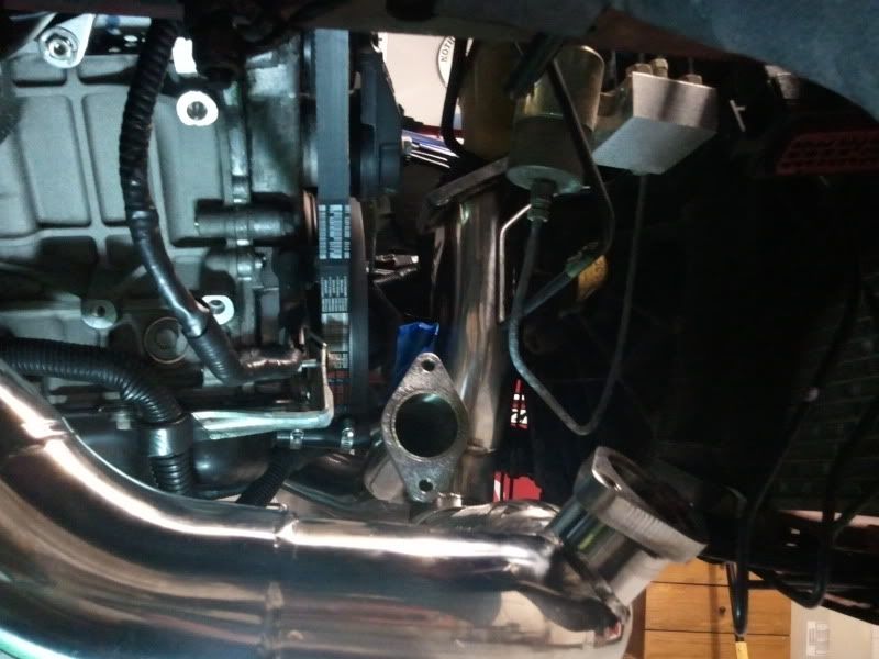

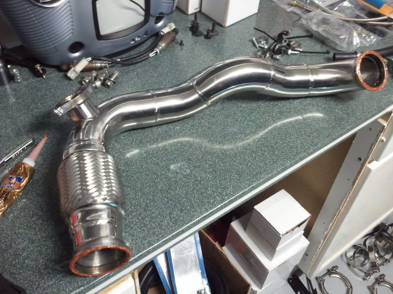

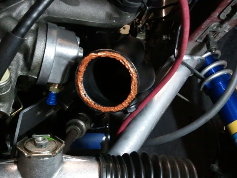

I was very impatient, installed these in a few hours after the kit arrived....so soon that I forgot to take pictures....my bad
Instructions tell me not to install headers before oil filter relocation....BLAH!
I did not use the hardware that came witht he kit for the header bolts....I used "Stage 8" Bolts as I have always had great luck with them.
I ALSO (which I may regret) decided to use the header gaskets that came with this kit....they are the cheapo type....but I want to use the kit as it is. Anyone including myself can make a kit work, or "better" than it comes....but I have a feeling that this stock motor wont last too long....so I will coat everything and use better stuff the next go around.
Here is the "GT" lower radiator hose I decided to use. I chose to get rid of the 4V style system, to create some additional clearance for the piping in that area. I am installing a Meziere Billet T-Stat housing, along with a Meziere 180deg T-Stat
VMP HPX Maf, VMP MAF Flange, VMP Harness to adapt the 05+ slot style MAF
Meziere Billet T-Sta housing, and T-Stat. AWESOME PART

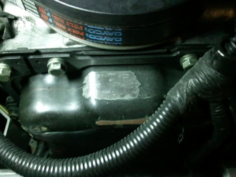

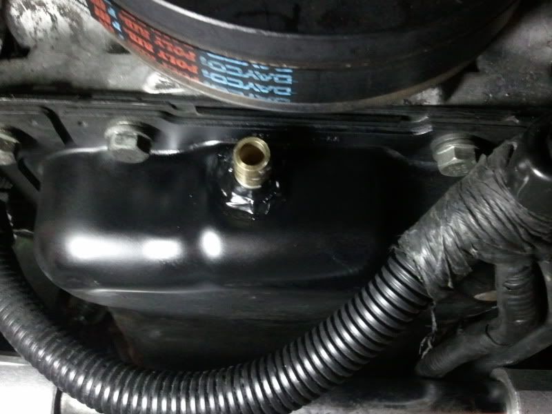

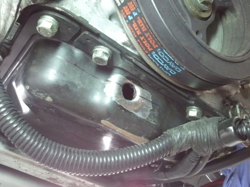

5/8" down from the top of the pan, 1-7/8" to the right of the middle of the second oil pan bolt (looking from the front towards rear of car)
Grease, 3/8" NPT Tap, Punches, Gasket Maker, and the fitting for the pan:
9/16" Hole Punched
Grease Applied to Tap:
Grease doing its job, lots of metal shavings:
Fitting installed with lots of gasket maker:
Before I button this up, I will be putting the hose ont he fitting, and putting about half a quart of oil through it, to wash away the shaving to the bottom of pan....so when I drain the oil, hopefully any shavings that were missed get drained.

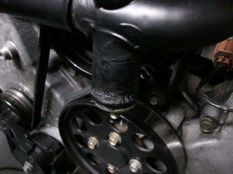

For those of you interested in doing the same with your coolant system, here is the plug I got from Advanced Auto Parts.
It is a Dorman, 02600.
And here it is installed into the tube. I will make it look better with a rubber cap later on.
This weekend I hope to have everything just about done, with some good photos to share. Thanks for the patience!

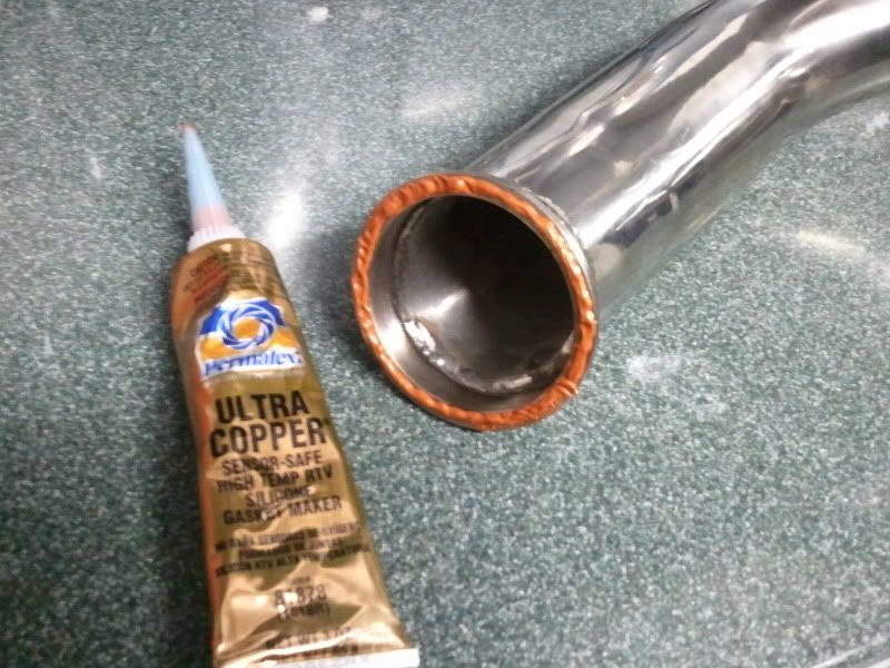

Up to this point, I am simply amazed at the quality, and ease of install on this kit. I have yet to look at the instructions once during the install, and don't think I will to b honest. Everything seems great, and I am highly excited pressing forward. My wife actually mounted my merge pipe, so I hope it doesn't come back to haunt me.
I still have a bit to go, but remember.....I have already pretty much mocked the entire kit.....so even though the pics below aren't much more further, I already know how it will fit. This kit is far exceeding my expectations, that is 100% truth.
Copper RTV, just to be on the safe side.
In/from my past experiences, you can never have too much of this stuff. It says its good to like 600-700 degrees....but it works on hotside turbo piping. lol
Is this piping not just gorgeous? It is nice and thick, and also pretty heavy. NOT like other Ebay type kits I have dealt with in the past, for sure.
Very nice merge pipe. Notice the RTV....lol
