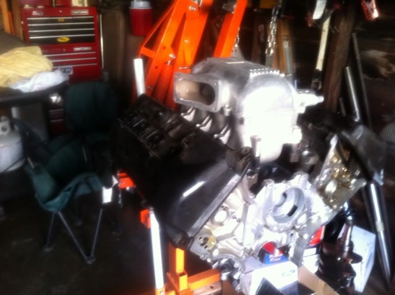

A fue pics mocking up things before I sent it to the builder,

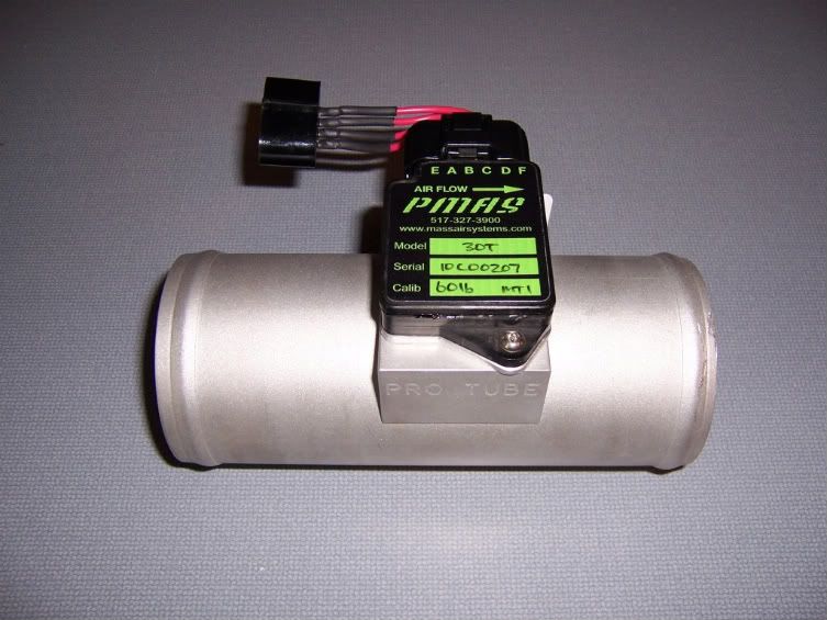

Anyone got a link to something just like this just by SCT in a slot style? Or any input on using this on my setup?
Originally Posted by PowerAdder Solutions View Post
PMAS Mass Air Meters, Quailty at it's best...Let us know your needs and injector size for calibration. Please PM or Call for price.
Thanks, Chris.
Pro Tubes are avaliable in 3' & 3.5' for piping combination. Great for Blow Through Procharger Kits and Turbo Systems.
Thank You. PAS Inc.

Hey bro just buy one of the VMP slot tubes, the SCT BA5000 or HPX will fit right in.
X2.....
