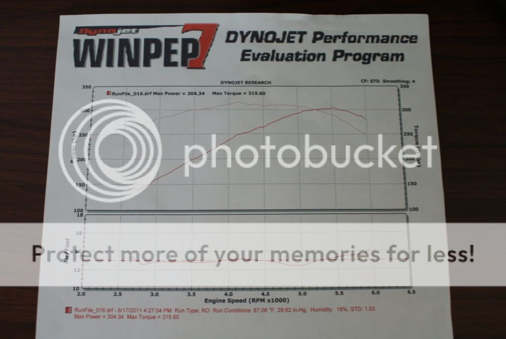

Are you saying the car makes 304rwhp now? Got a graph? I'd like to see the curve, I don't think 304rwhp sucks at all. Ran it at the track yet?

Yep, that's what it made NA. Here's a graph. The thing runs outta steam before it hits 5700.

Looks like solid power and a nice curve to me. I'd probably not want to go much past 5700 anyway with the power it'd be making on a stock block. I'd just slap a turbo on, tune, and have a blast.
