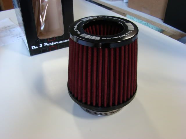

We had 3 different filters made for the turbo applications we sell. We have a reusable/washable cloth element filter and a new stainless mesh option like you see above.
This is a nice filter for the sn cars, its a little smaller but the filter room is more limited on those cars unless you have our cold air setup to go into the inner fender

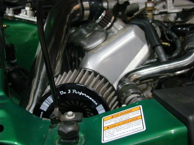

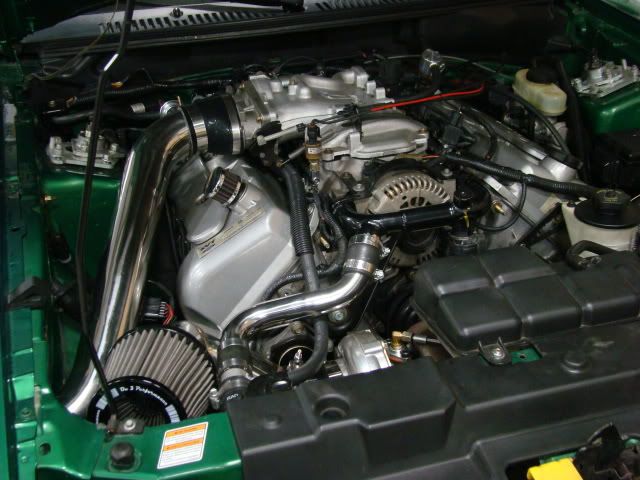

Random shot of the filter setup I made for my 4v and the new stainless element filter

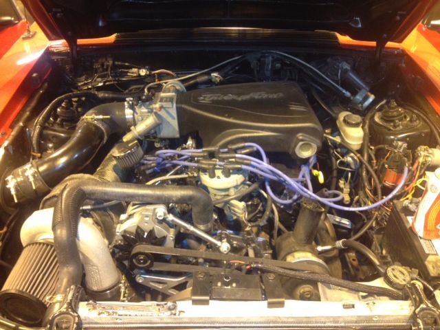

got ahold of the tiny spectre one, dont care about flow itll come off at the track. But its smashed into my radiator hose now, any fixes? Running a 95gt hose on my 92 lx
I cut about inch and a half to two inchs off the upper hose at the radiator of a 95gt hose. It's close but it clears
got any pics?

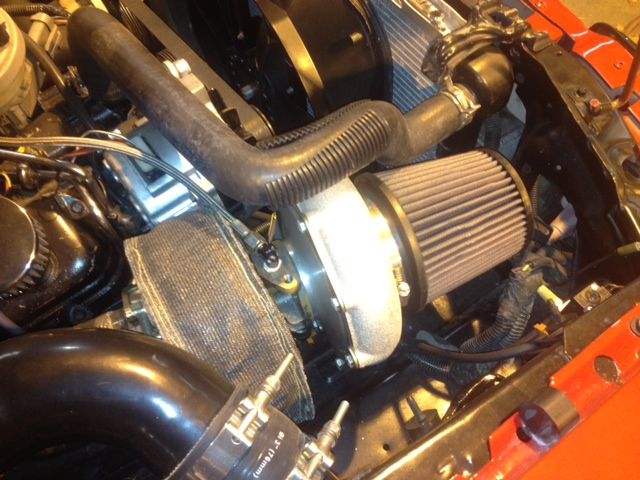

Here My setup with a Precision 7268 and a K&N filter........
